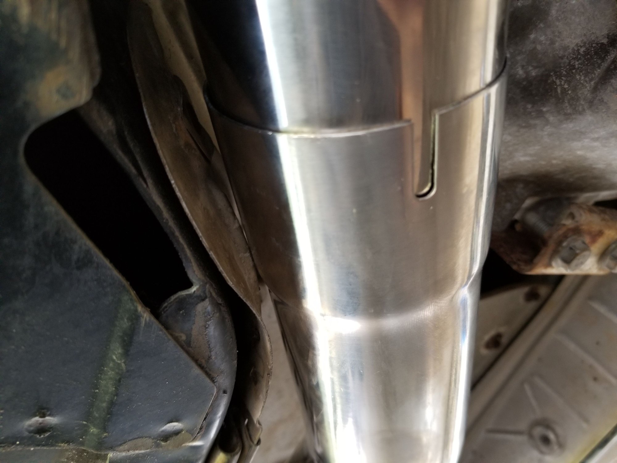

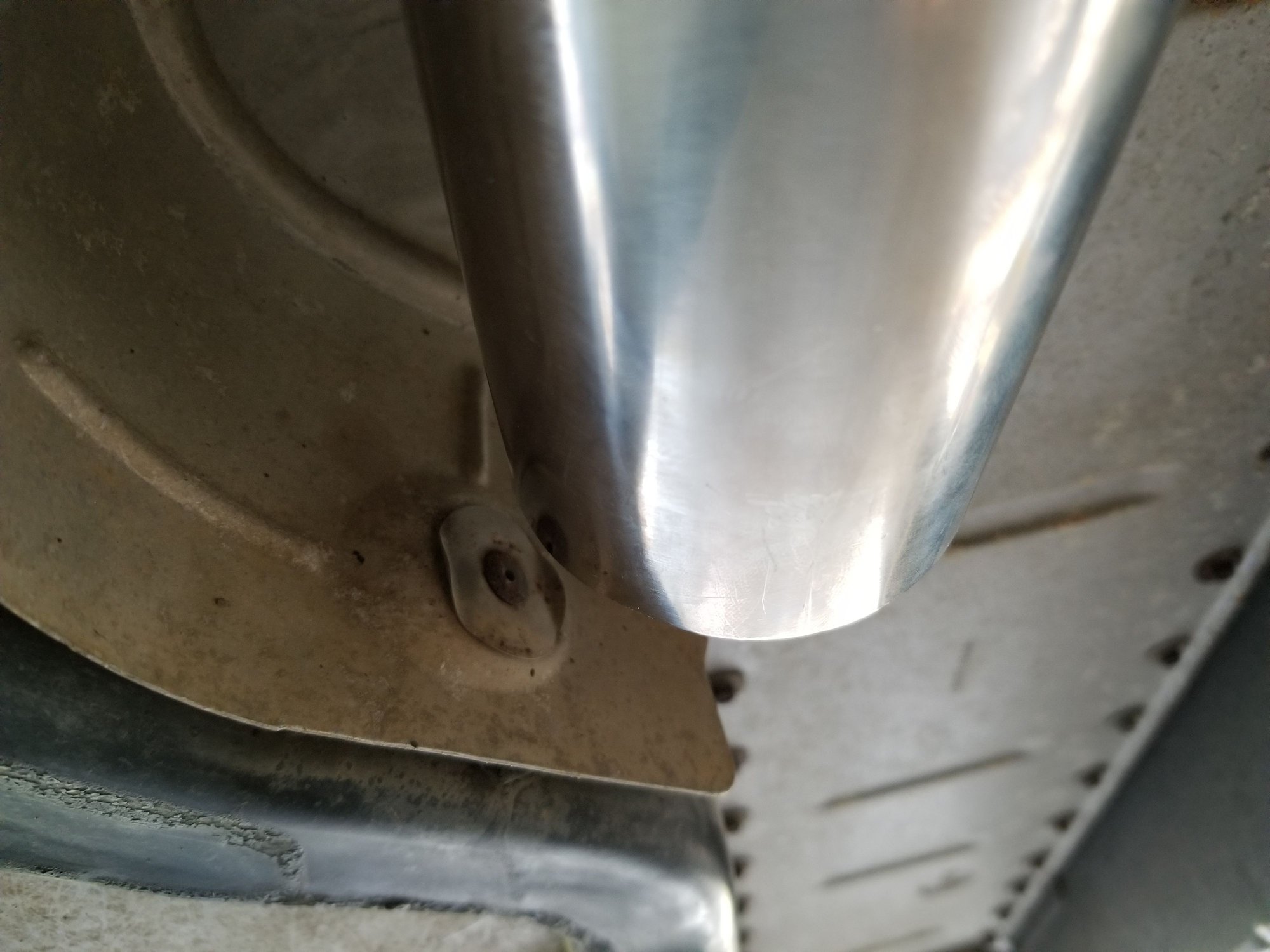

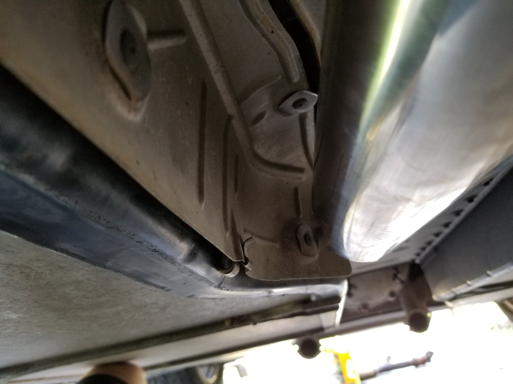

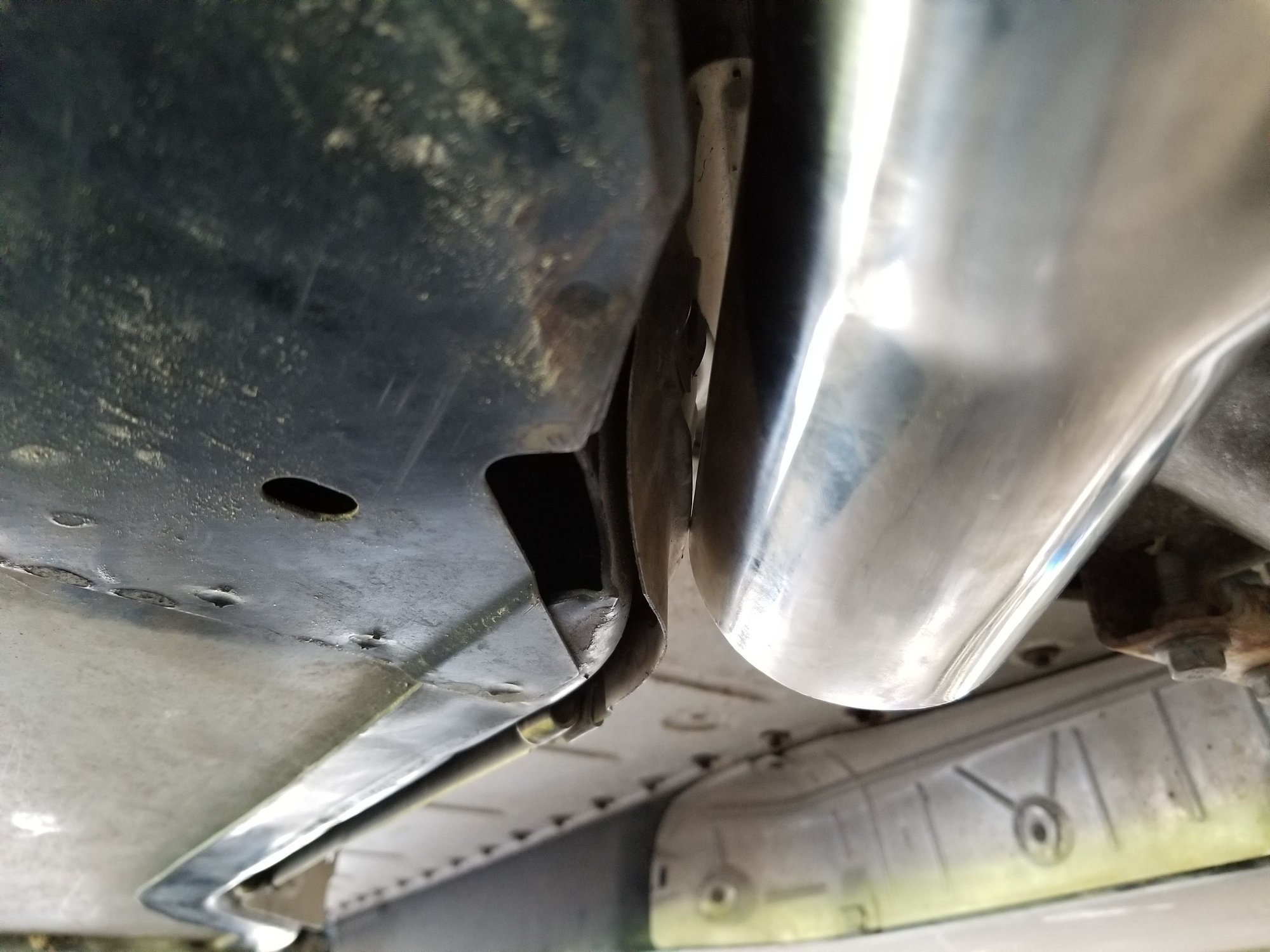

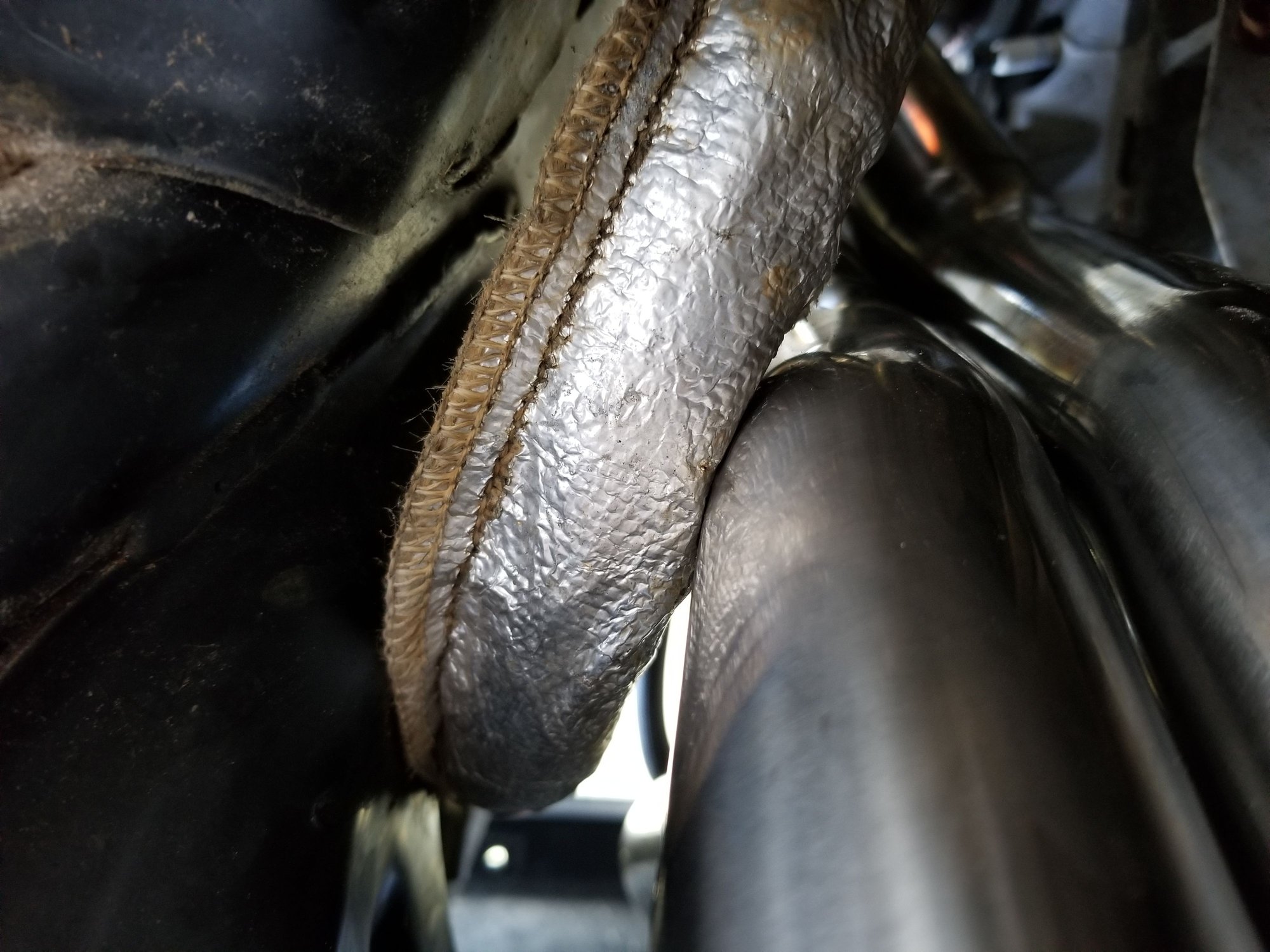

Default Some pictures now that it is light outside.
Header collector hitting the channel wall.
I can manage to squeeze/wedge the next exhaust peice on, but then I run into this issue:
The pipe runs directly into this part of the exhaust channel. Keep in mind, this is with the header torqued down, and the midpipe peice slid over the collector with no clamp, as I can't even get the clamp in place. Even if I try to force the pipe to the side with no clamp on, I still can't clear this place where the channel wall comes inward.
A few other pics:
The AC line issue is really the least of my problems. Although I shouldn't have that issue to begin with, I could probably find a way around it. However, there is no simple way around the big issue with the pipe running way off track and hitting things. Sorry if the pics and angles aren't the greatest, I tried my best but my jackstands are almost maxed out and there isn't much room to hold my phone while laying on a creeper. I'm sure you guys can see the issue though, it's pretty obvious even in photos.
