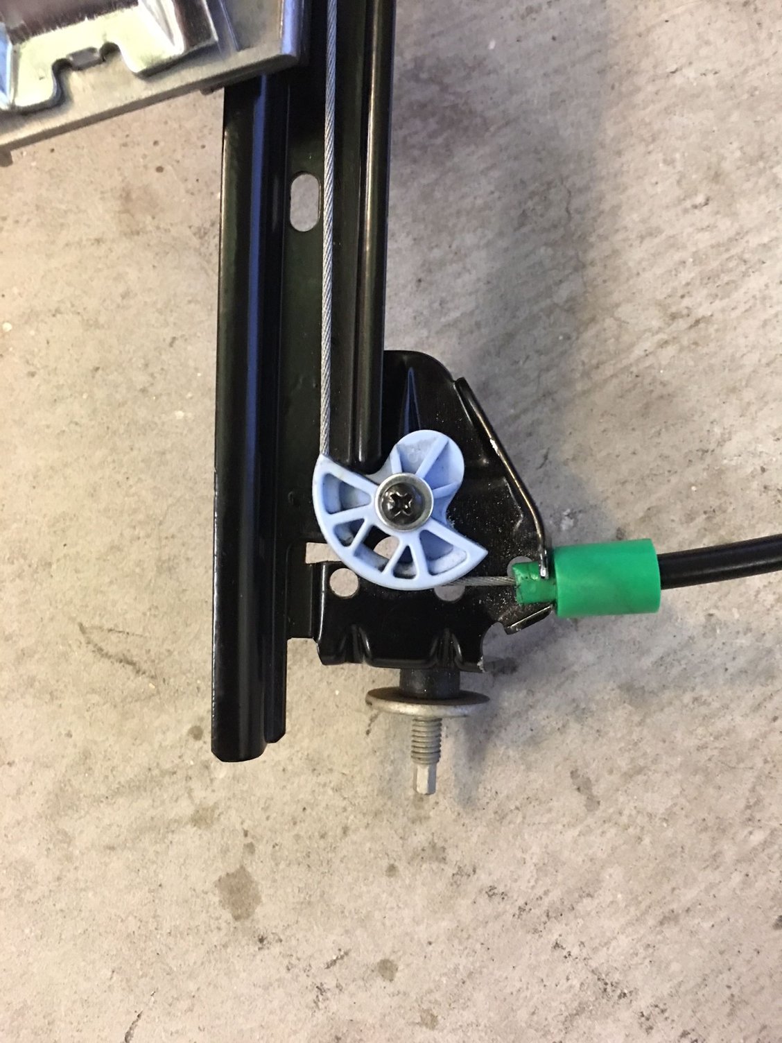

Unfortunately you're going to have to take the door apart. The problem I had on both of my windows (they both went bad within 2 weeks of each other) was that the holder of the idler wheel broke. I wound up just putting a screw in place of the plastic tabs. But it was a pain to get the wire to go over the wheels. Good luck.

On each of my windows, I heard something hitting the door. It sounded like it came from outside, but it was the idler piece breaking off. Here's the piece with my fix of putting a screw through it.
