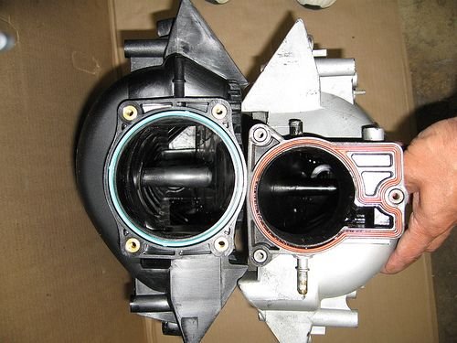

LS1 Throttle Body next to LS2 Throttle Body
The LS1 throttle body is a three bolt design with a 78mm opening. FAST intakes require a four bolt throttle body. The LS2 throttle body is a four bolt design with a 90mm opening and will bolt right up to a FAST Intake, however, a wiring harness is required for the conversion. Cost of the wiring adapter is about $55.00. The LS2 throttle body will easily out perform the LS1 throttle body. I wouldn't do one without the other.
