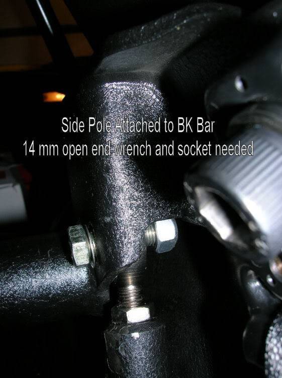

I thought I would ask a question regarding the installation process on the BK Harness Bar. Everything is pretty straightforward except the 2 vertical bars that run alongside the waterfall area. Per the thread above he bolted the bars to the inside of the main bar image shown here:

Which is the correct way or which way are most of you guys installing the bars? Only difference I notice by mounting them to the inside as shown on the thread is they make contact a bit with the plastic trim piece the main bar mounts alongside.
