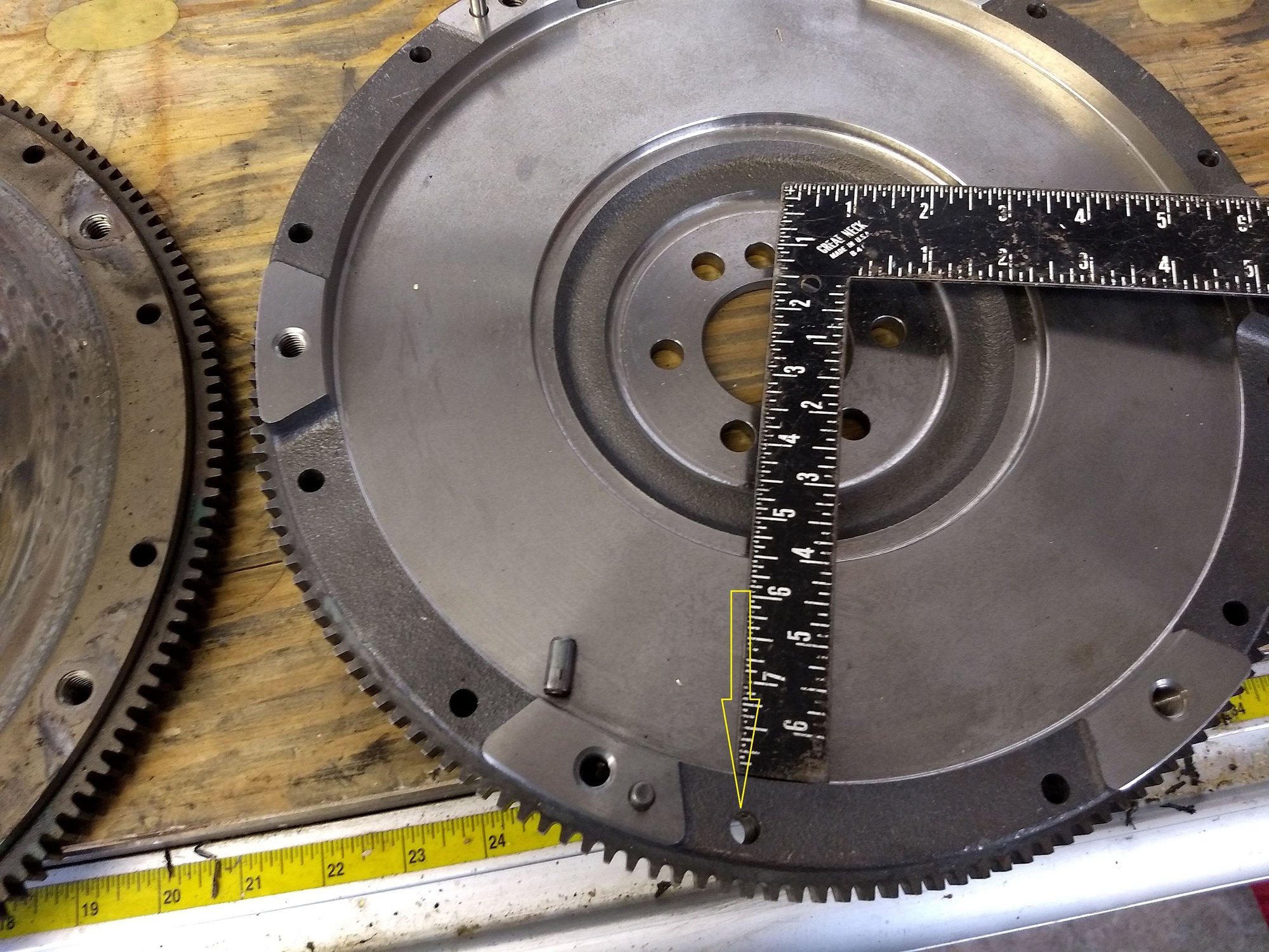

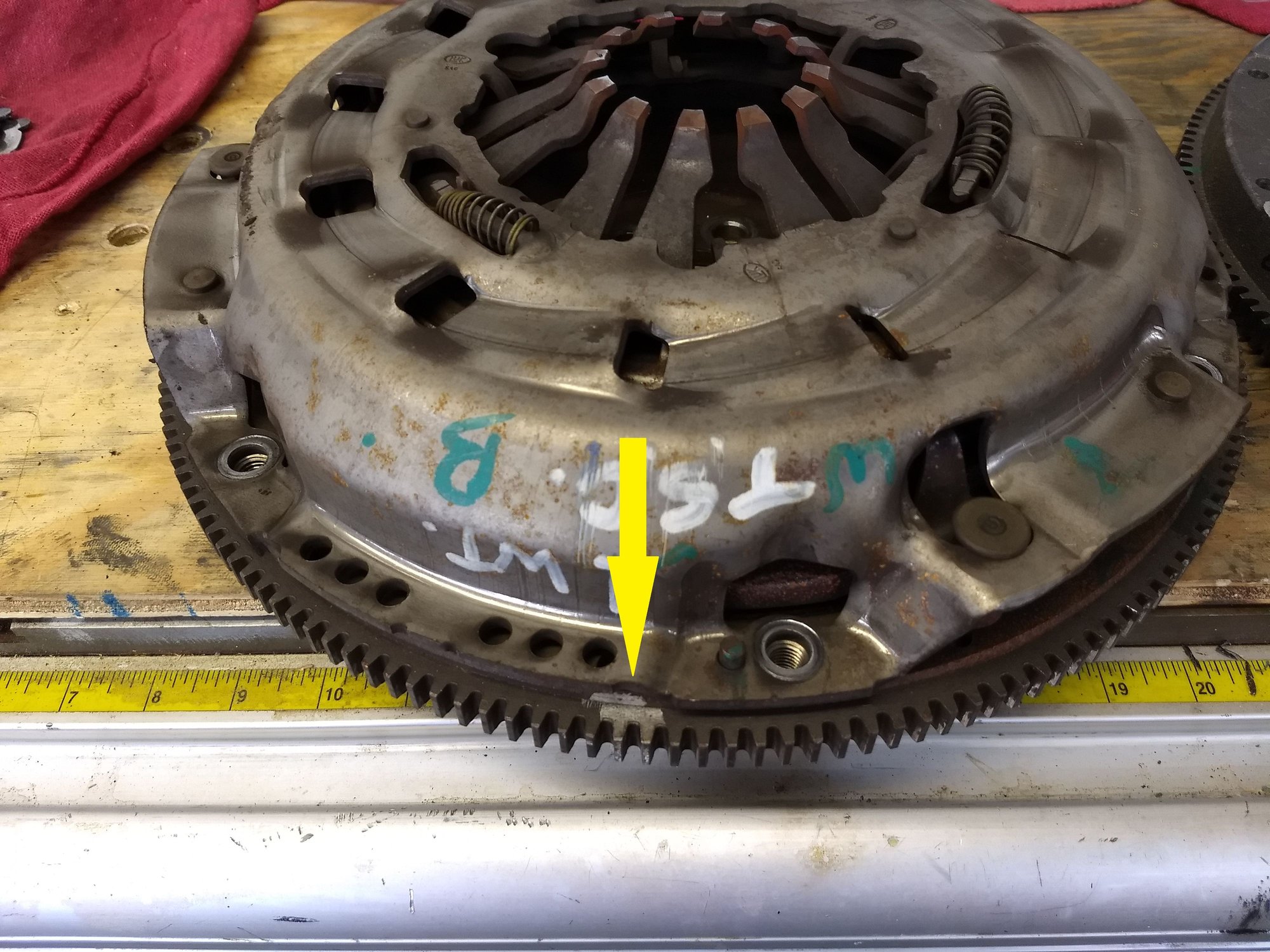

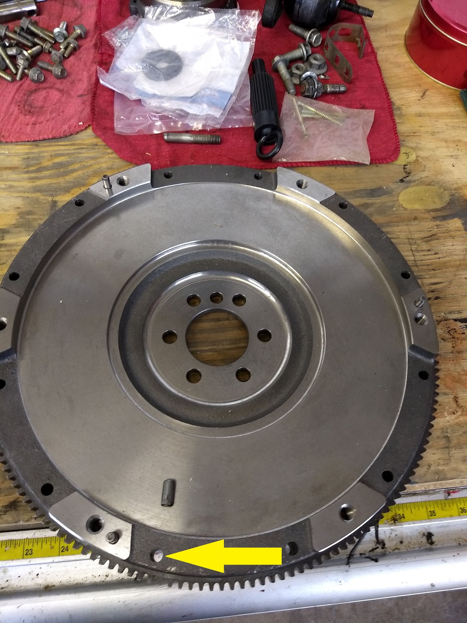

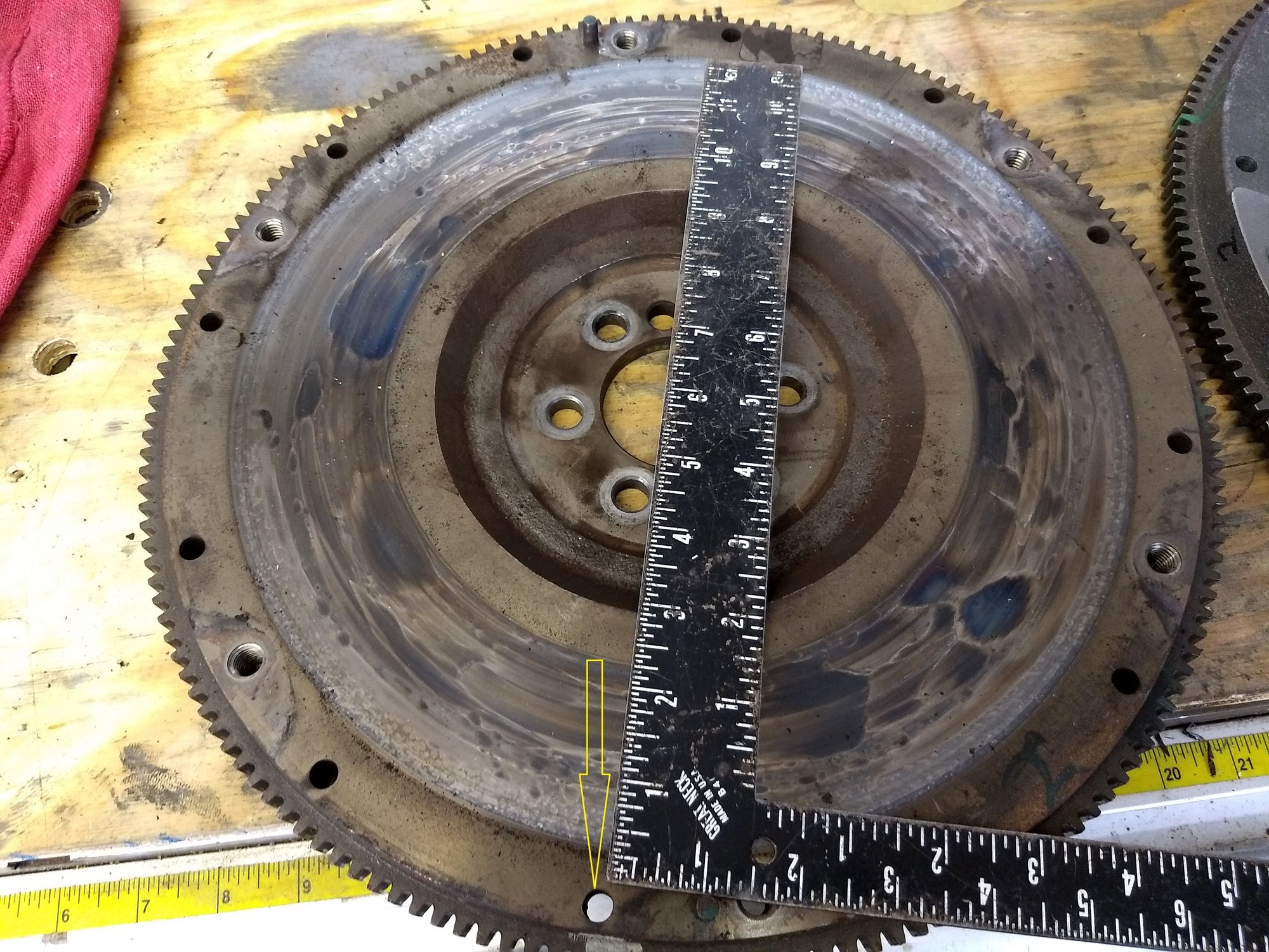

Wife and I are going with a LS 7 clutch setup in our C 5, I thought at first the weight holes didn't match, then rethought and now seems right ??? any input ???

Not sure if this will help, but it's a data point nonetheless. When I upgraded to my LUK LS7 Clutch Kit I got from Amazon (Clutch,Flywheel, Pressure plate, bolts...etc.), it comes prebalanced. My mechanic did not do any other balancing, just installed. I have no out of the ordinary NVH from this outcome.
