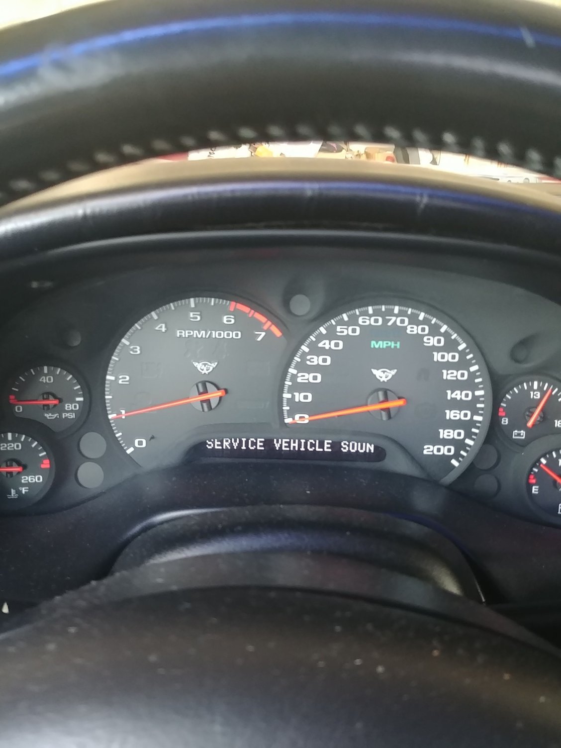

Really? Do the gremlins ever go away?

Oh I'm well aware...my '99 f150 never does **** like this

At least it has good oil pressure...
Good eye. Well done, well done.
Old Nov 4, 2018 | 12:44 PM
acres90's Avatar
acres90
Joined: Jan 2011
Posts: 115
Yeah i guess it did have good oil pressure...no knocking lol after I washed it and started it, all normal 😐

In all seriousness what DICs is it showing?
Old Nov 4, 2018 | 01:18 PM
acres90's Avatar
acres90
Joined: Jan 2011
Posts: 115
P0522 b2282h b2264 b2283 b2285 u1016 b0851

I thought I had taken care of all the gremlins after I had the EBCM fixed but they didn't go away until after I replaced the ignition switch. More than 400 miles now and no codes. 2002 with 103,000 miles.

The ignition switch took care of the service engine soon? Mine has been on for a couple of years might be worth looking into that.
