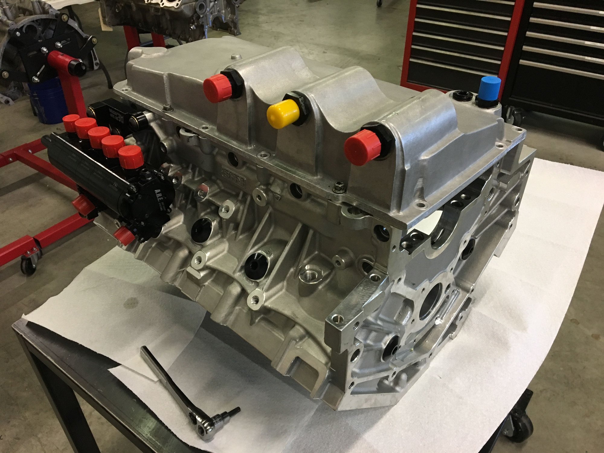

Assembly should officially start next week and we will work on getting pictures prepped and ready for posting along with a full detail of what all is going on.
The blog will feature this as things go together, not really how it was planned, to do that you would have to read the article in reverse.....starting with the intake.
So before I take off for the weekend I will leave you with one more sneak peek into the build showing off the 5 stage ARE dry sump that will be used on both 527's.

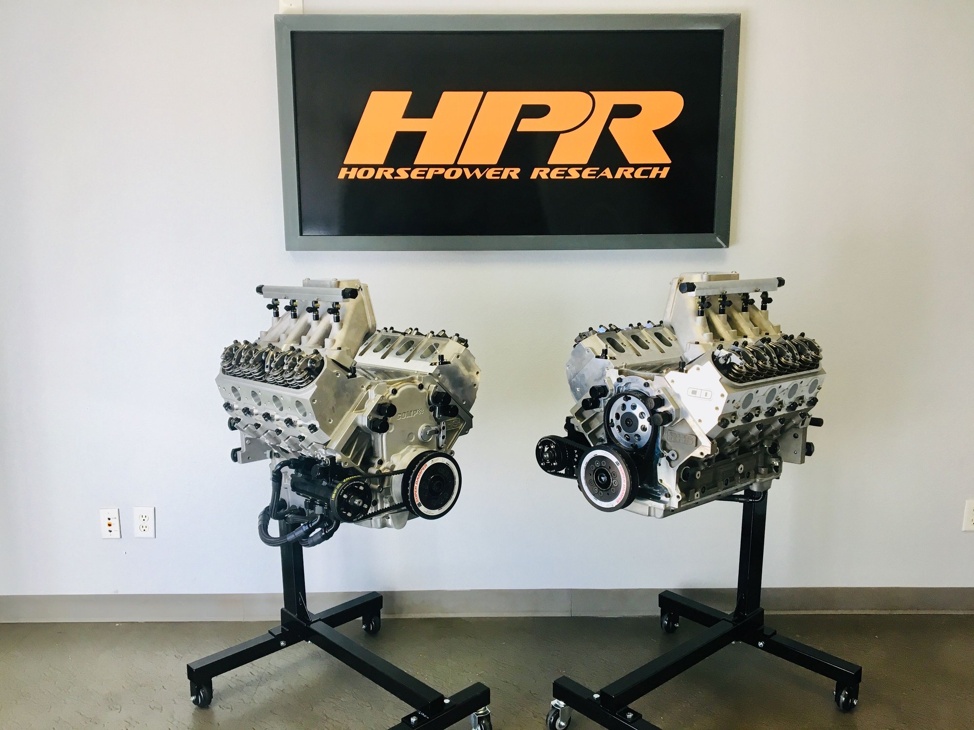

Sneak Peek before the show.
Write up will have to come after we get back from the show.

I feel special that I actually seen these engines in person and laid my hands on them as well. - Just way too cool! Love the Plexiglas panels to view the engine components. The ports in those heads are monstrous
It would a great show. Did you get to see both of them or just one?
