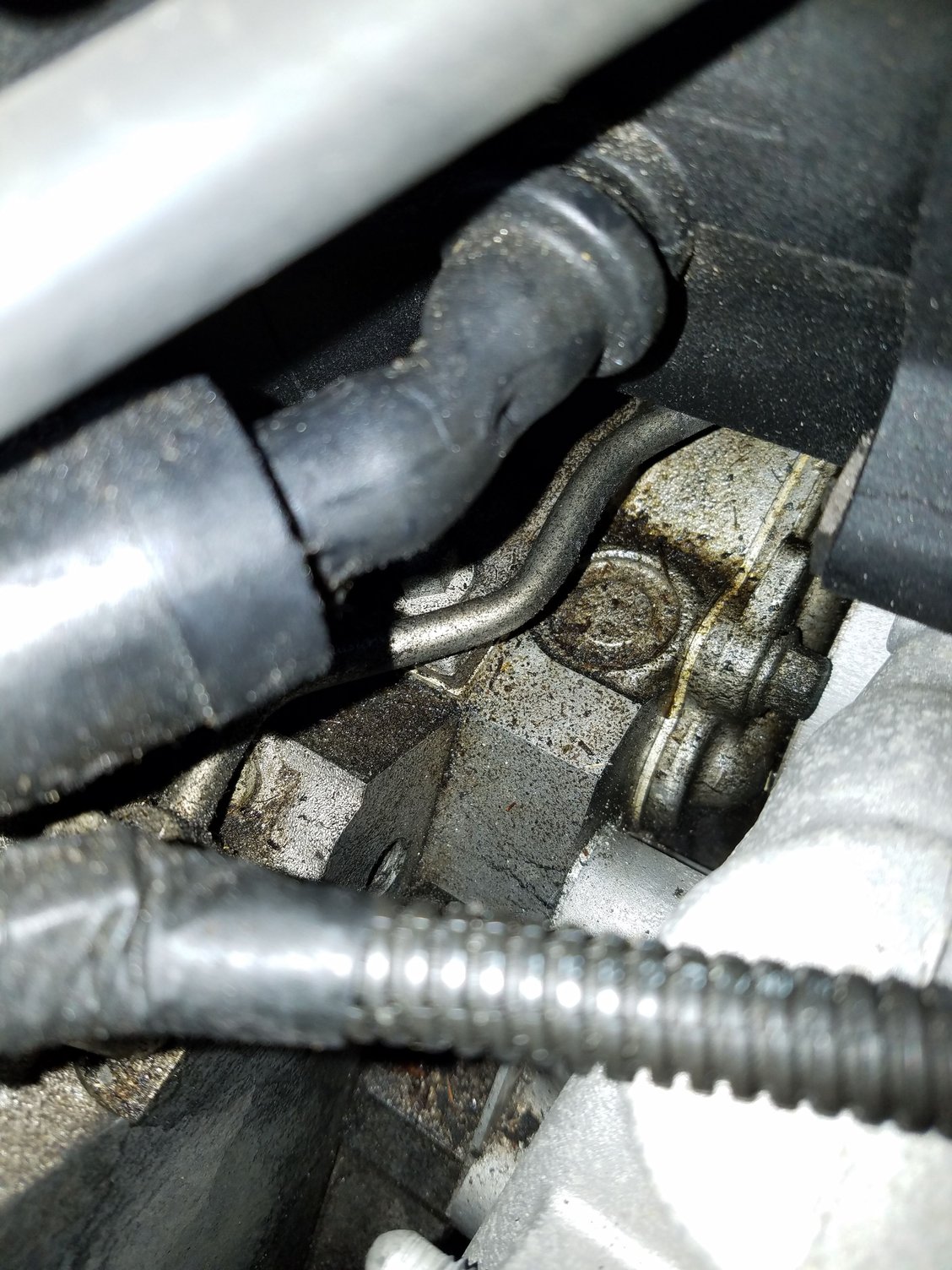

Been getting a check engine light (codes P1071 and P1074) on my 2000 Coupe (6M, 141K) and have discovered there is a hole in a hose coming off the Throttle body. Is this part of another part of can I just replace the hose section.?

Replaced the small 2" piece of hose on the end. Problem solved.
