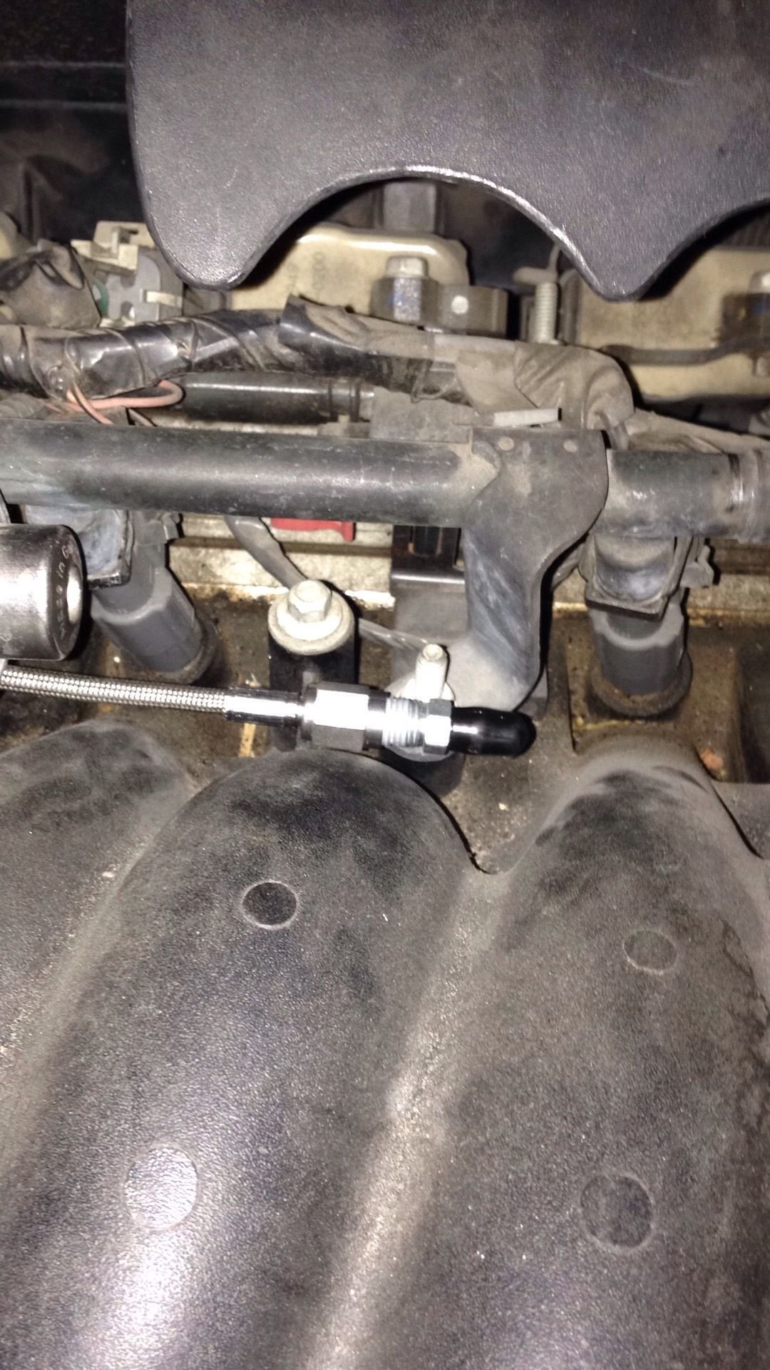

Took the car for test drive and it shifts great!
Feels like a different car, this should have been done years ago.
So I bought the car used in April 2003 and even then it didn't shift this good, over the years it got worse and worse.
Now need to do a review on Katech also, got a email asking me to do after getting the bleeder kit.
There was a lot of crud that came out.
After bleeding I could hear the clutch squeaking when pumping pedal, it never made a sound before, so that told me it was getting more movement.
Putting the car in reverse, it just smoothly popped in, usually it wouldn't go, and I would go back to neutral let off clutch, press clutch again then slam it into reverse.
Goes in first much easier too, 2nd not having to hold it into gear by force anymore.
So far every shift is better, need to drive freeways and see how it goes from 6th to 4th(when traffic or a slow driver slows you down) 4th usually would grind if I shifted with the engine at idle(let off accelerator shift from 6th to 4th with or without pressing on brakes to slowdown car)
I guess a regular bleed would have done this too, but dropping the exhaust and tunnel plate each time would suck!
Have bleeder under Corvette fuel rail plastic cover, used LS1 intake bolt to hold the bleeder's hose support.

LS1 intake bolt going through hose support clamp.

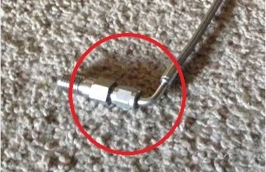

Just bumping this up because I realize the Katech remote clutch bleeder has a FLAW. This was somewhat addressed above as well.
So the Katech remote clutch bleeder line uses a swivel -3AN fitting on the bleeder end. A 3/8"-24 speed bleeder threads into that. (the threads for -3AN are 3/8"-24)
A speed bleeder is a check valve that only allows flow when there is sufficient pressure built up. Fluid is released only when pressing the pedal and air won't be drawn in when the pedal is released.
Well, an AN swivel fitting ONLY seals when it is tight. Therefore, when you crack open a bleeder screw (as you do with any bleeder valve) in a swivel AN fitting, fluid will leak through the swivel fitting itself. When using a speed bleeder this means that pressure CAN'T build up and fluid ONLY flows/leaks through the swivel fitting. Also means that air can be drawn in when clutch pedal is released.
Therefore I wonder: what's the point of Katech including a speed bleeder???

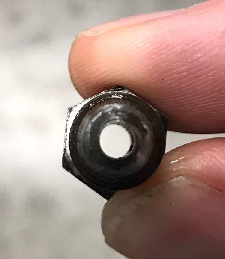

Installed Russell 641291 fitting after using a regular 21/64" drill bit (135 degree tip) to drill out the female inverted flare. Naturally a 135deg seat and the speed bleeder's 90 degree tip won't exactly jive nicely... but recently I had success with this combination on a brake caliper in my other car. (brake hydraulics experience much higher pressures than clutch hydraulics)
Anyways, the 90deg. tip was able to nicely create a little seat into the 135deg. drill point on the Russell fitting. Here's what it looked like after screwing them together prior to installing on the car:
You can see where the sealing band resides, and IMO this is plenty of contact to seal the relatively low pressure clutch hydraulics.
Oh, and if you're wondering, it was AMAZING being able to use the speed bleeder as, well, a speed bleeder.

MetalMan,
Based on the description above, I assume you found it leaking here at the side of the torque tube?
I didn't have any leaking in the area you circled. My description was for the fitting at the speed bleeder end, and it wasn't a leak per-se, except when the speed bleeder was cracked open it could let air in.

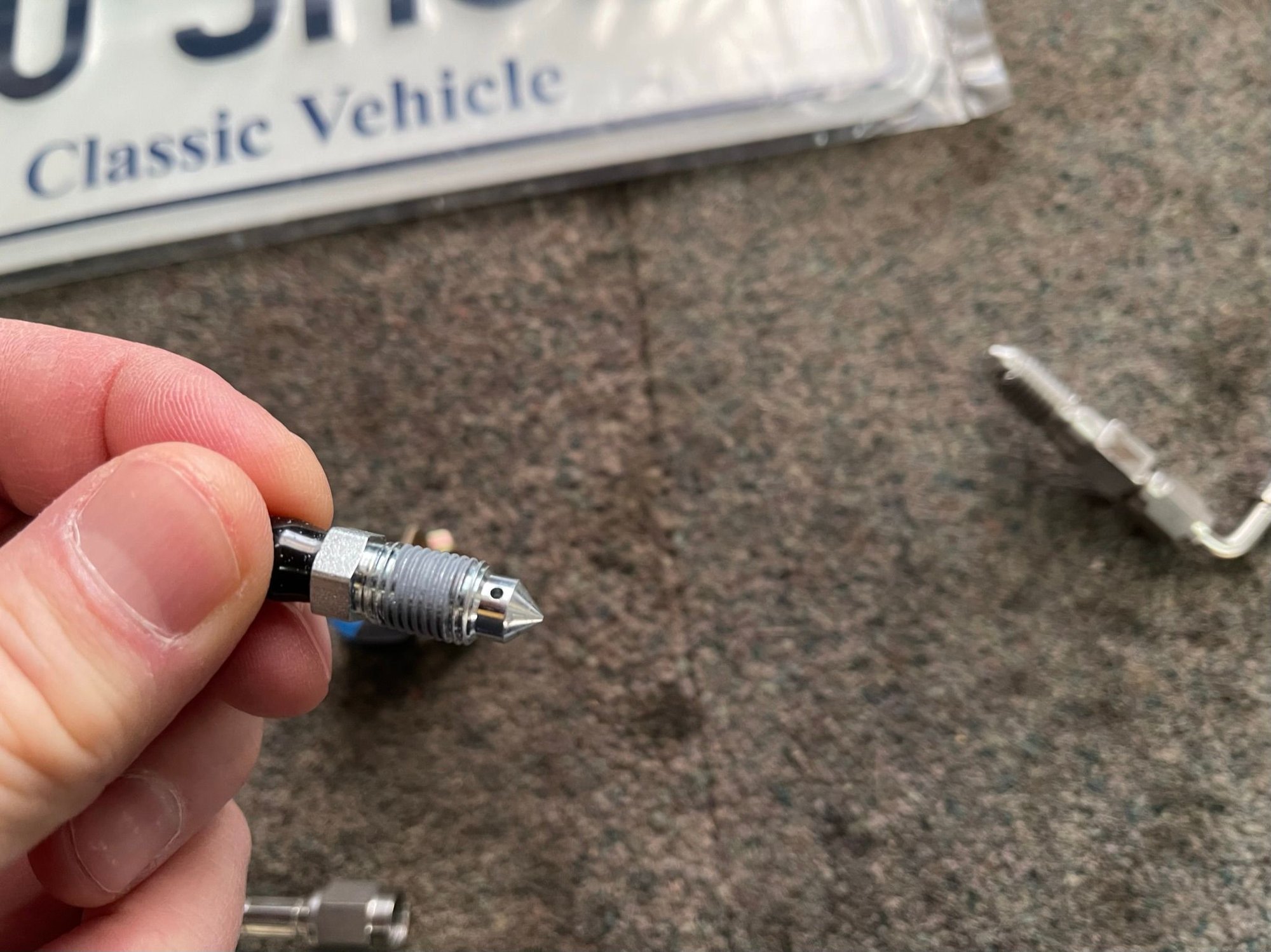

Unrelated to anything I posted in this thread previously, but at one point I did end up with a leak in the fitting that screws into the slave cylinder. I had replaced the slave cylinder, and compared to the original slave, the new one had shallower threads for the bleeder screw. This meant that the Katech fitting couldn't be screwed in all the way, and therefore it leaked.
Here's an image of the Katech fitting vs. stock bleeder screw. You can see how the Katech fitting's threads extend further down, and my new slave cylinder couldn't accommodate this extra thread length.
And I modified the Katech fitting so it could fully seat into the slave:
So I got my Katech bleeder today and see 100% how the swivel fitting would bleed fluid out before it reached the speed bleeder. My next question is, if the bleeder's tapered seat is sealed, and doesn't have a hole at the point of the taper, how does the fluid enter the hole on the side, even if using the Russell fitting? Doesn't that mean you still need to crack the speed bleeder to get fluid to flow. thus creating another way to bring air in? I'm a little dense, so I may not be understanding properly. I was looking to get the Russell adapter, but I'm having trouble seeing how it works without cracking the bleeder.
Thanks,
Ian
You're right that the speed bleeder has to be backed out slightly to allow fluid to flow, just like a normal bleeder screw.
The thread sealant on the bleeder screw's threads helps to mitigate air entry past the threads. In my experience this does a pretty good job, although after enough time the thread sealant will wear down and require re-application.

I received my Katech remote bleeder and (not installed yet) just bench tested the speed bleeder swivel fitting to confirm the reported air leakage. What a #%*@ design especially given the product's price!
No one seems to be reporting the slave cylinder adapter fitting to be an issue, so that is good news. The machining of that piece (matching the OEM bleed screw specs) seems to be what sets the Katech apart from other remote bleeder kits. So, the product's only problem seems to be the hose design at the bleeder end.
I like MetalMan2's solution. It looks like a proper fix that is adapted to Katech's inadequate hose design, which makes sense if the Katech remote bleeder is already installed on the car.
Since I have not yet done the Katech remote bleeder installation on my car, I'll upgrade the Katech hose with an Aeroquip FBPA0039-36, which is a 36-inch long PTFE hydraulic / brake hose with 3 AN fittings at each end (link ---> www.summitracing.com/parts/aer-fbpa0039-36). My expectation is that Aeroquip's 3AN fitting will not leak air, but I won't know for sure until receiving the part and bench testing it. Also, I'll attached a Russell 641370 3AN speed bleeder assembly (link --> www.summitracing.com/parts/rus-641370) to the end of the Aeroquip hose for a leak free solution on the bleeder screw end.
I'll follow up to report if the Aeroquip hose and Russell speed bleeder assembly are suitable upgrades.
