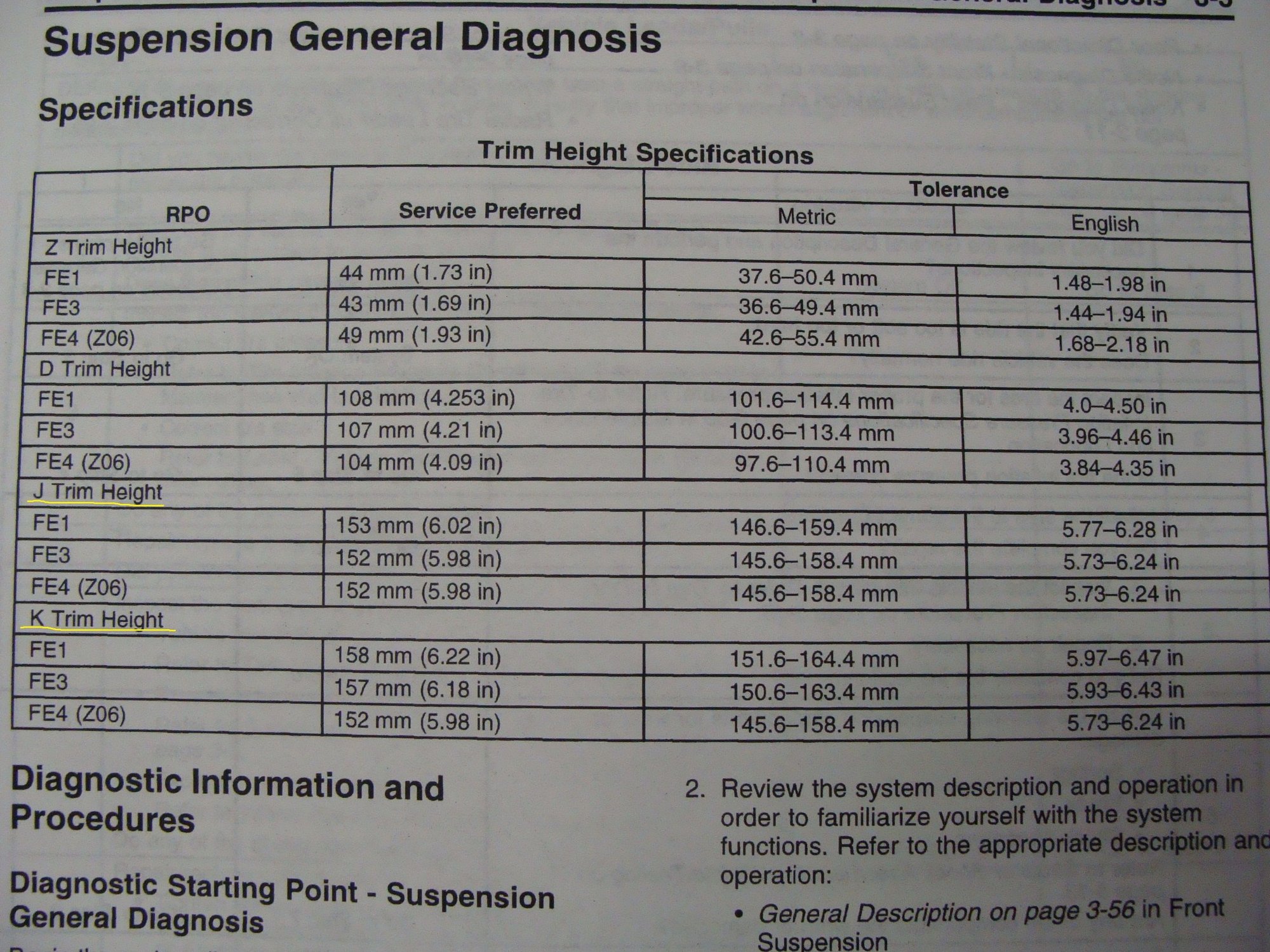

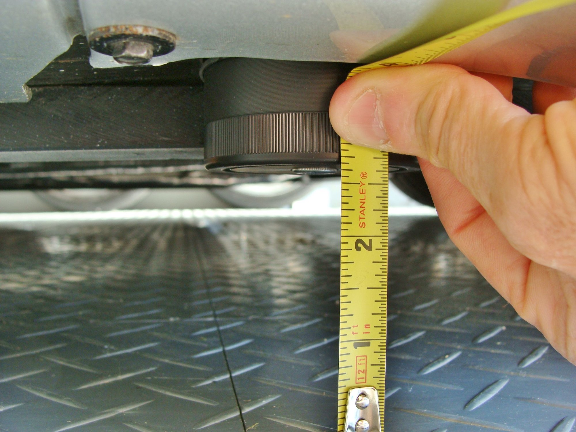

An accurate way to check your ride height if you do not have a trim height tool is to use the J & K jacking puck locations, I install a puck making sure it is tight to the frame, measure to the ground, then add the height of the puck to get my height, as noted below you can see Z06 spec is level, coupes & convertibles are 1/4" higher in the rear as they run a taller tire.
For a simpler way using your wheel well heights, I make sure all tires have same air pressure, measure from ground to top of the rim, and from bottom of the wheel well to top of the rim and add the two to get the measurement.
I use both measurements to set my ride height, even with a level rocker height the rear wheel well opening will be higher in the rear than the front, mine is 1/2" 25.75" & 26.25"
