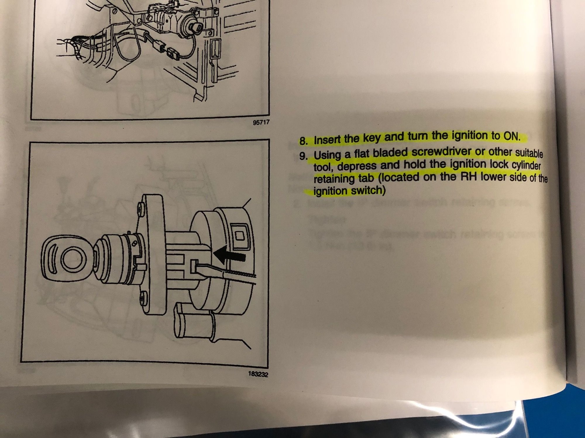

On my 99 suddenly the key will not turn. I've read the posts on replacing/repairing the ignition switch, but I haven't seen any advice for how to remove the cylinder or the switch if you can't turn the key. It appears you need to turn the key to 'on' to remove the cylinder, and turn the key to 'on' to remove the park/lock cable from the switch.

From the 2001 FSM !!

Thanks, but this only works if the key will turn....mine will not.
Any ideas?

Got my original switch and prepared to remove the cylinder and swap out the electrical plastic part. Tried the key. NO TURN. You are right you need to turn the cylinder innerds to on to remove the cylinder and park lock cable. Finally had to drill out center portion of the cylinder being careful not to wreck the back part. In your case you can leave the switch in the dash after you spend an hour or so taking out the console, ash tray,and dash panels, and then drill out the cylinder just enough to get a large flat blade screwdriver in the hole you drilled to rotate the cylinder. Once done then remove the 2 screws holding the switch to the dash, move the cylinder with the large screwdriver to on, and depress the release tangs on both the cylinder as shown on the diagram posted above and also in the park lock cable. Several entire assemblies are listed now on Fleebay. Pick one, Get the cylinder rekeyed at the cheapest place you can find to your existing VATS key, then move the wires from the back (white and black connector), VATS cable which is a small cable with only 2 wires and is partially wrapped around the front of the cylinder, and the park lock cable. Will be a PITA but you can do it.
