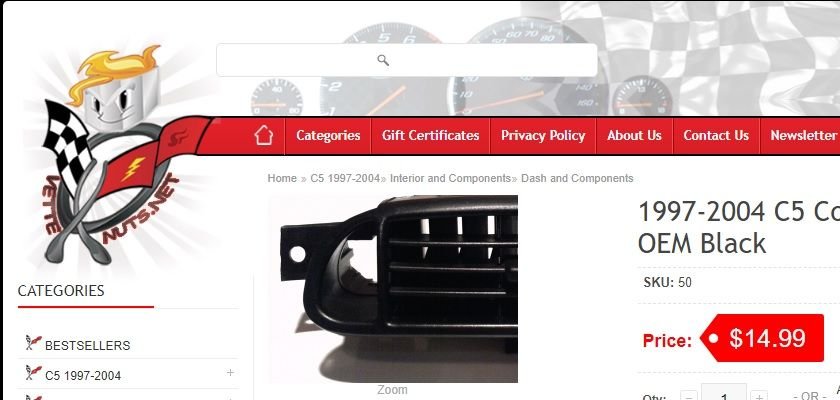

Well my experience indicates you guys were lucky. I also note that when I look up a center vent on Vettenuts the one they display as a replacement appears to be broken on the bottom -- not fun. Every part of my car is more brittle today than it was just a couple of years ago. I imagine that's true for all of us.
