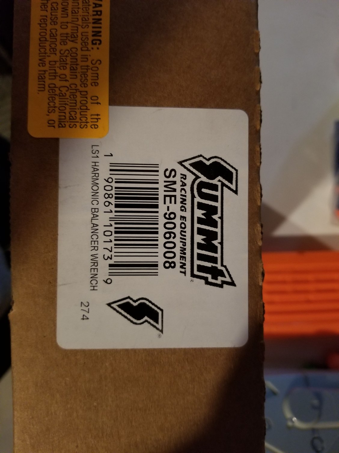

Guys, I replaced my harmonic balancer this past weekend and this tool made holding the balancer when removing or installing a breeze...got 235 ft pounds with my arp bolt pretty easy...no need to remove starter or anything like it...39 bucks is all it cost from summit and was way worth it.....in addition, I heated the balancer hub with a heat gun to 250 degrees and it slid on the crank snout enough to screw in the arp bolt, minus washer, to seat it...just an fyi to help guys thinking of doing this work..
