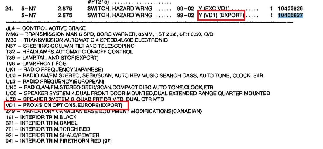

Hello Niklas, this CF is being a pain in the azz uploading info!!![h1=right]Hazard Emergency Flasher Switch
Current GM part no: 10406627[/h1] Fits 1997-2004 C5 Corvette VD1 European Export.

Originally Posted by 69
Hello Niklas, I apologize for the Mish-Mash thread posting but the CF had issues uploading.The switch you installed is NOT configured for the EU Export C5… You need to get a P/N 10406627 that supports the “VD1” configuration.The company I work for has a facility in southern Germany and I have some coworkers there that own C5’s and every year, when I travel to this facility for meetings, I get their C5 parts “wish list” of part I need to bring with me! For my service, I get a C5 to run the Autobahn!!! Cheers,
