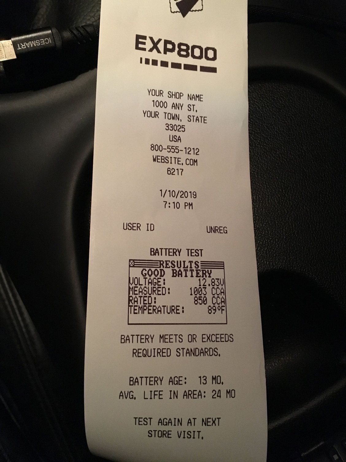

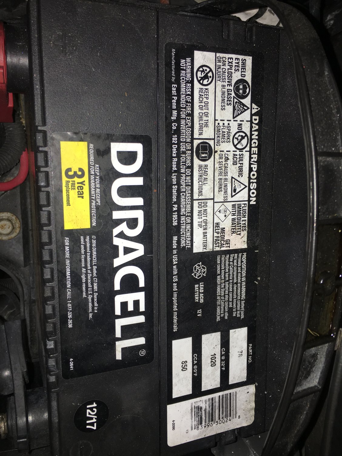

Oh boy, seems I'm getting random problems now after my cam build and tune that don't even seem related to the build. Anyway, latest issue is that my car would crank healthy today but wouldn't start. It's been driving fine last couple days and even last night, and it fires right up until this morning. I saw this morning that my battery voltage was below 12.5 (it varied between 12.1-12.3) and immediately suspected that this was causing it because I've heard about some of the system electronics are not happy below 12.5V. I ran with this assumption and went on to jump my car, despite that it cranked healthy and strongly, just to raise voltage above 12.5. With it jumped, it took a while but eventually it did start but felt like it needed gas pedal to keep it from stalling for about 6 seconds until it finally "woke up" and did it's normal cold-start idle procedure without assistance of gas pedal. Afterwards, it warmed up normally, idled normally, and drove normally and I was able to make it to work without further issues.
FYI: My WOT power is solid and I have no hiccups while driving or idling. Also, during driving my alternator takes over and raises voltage to between 14.0-14.5V or so.
Could this symptom be attributed to batt voltage below 12.5V? I'm tempted to go straight to get a new battery after work and start there.

Well yes I'd have the battery load tested first then proceed. Is the car MAF or "speed density" tuned ???...Without looking at some hard data we would only be guessing here...you have a scan tool ??...if not it could be:
