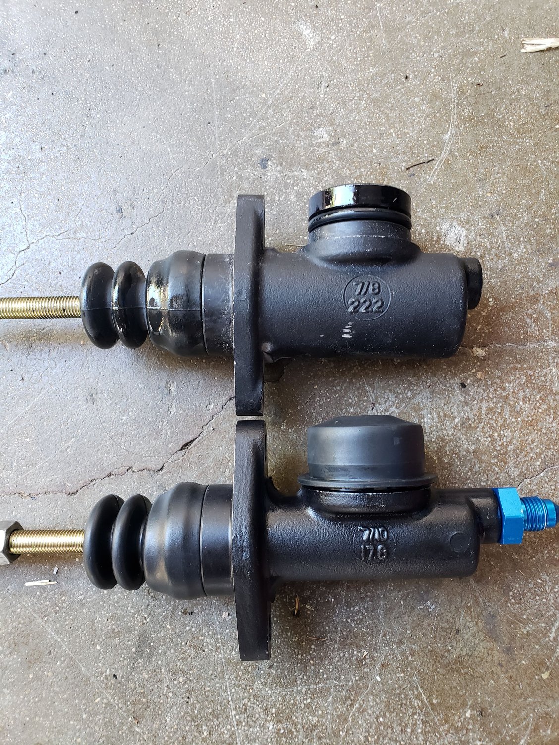

If you already have the tick master installed and don'tike the narrow engagement and stiff pedal converting the 7/8 to a 3/4 master works great.
Found this thread below...
​​​https://www.corvetteforum.com/forums/c5-tech/3306676-ditching-tick-mc-for-stock-what-do-i-need.html
As per the thread I bought a til-75-750 master from summit. It was 75 dollars shipped.
The one thing is that the universal master is not tapped for bolts. Otherwise it is a very straightforward swap using the other parts from tick.
Instead of taping the master, I put bolts and nuts through it instead. You have to open up the firewall a bit to do this.
My old tick master would not come out with the pedal box installed and removing that is a bit of a pain. I opened up the firewall enough with a dremel to remove the master.
I'm sure the firewall can be opened up smaller, nicer and more strategically... I made 2 different cuts, One to get it out and the other to clear the bolts. I'm thinking it could be done with one, where the bolt holes are. .
Super happy with this. The clutch is no longer on/ off and pedal pressure is just a bit firmer than stock!
Top is what comes from tick
