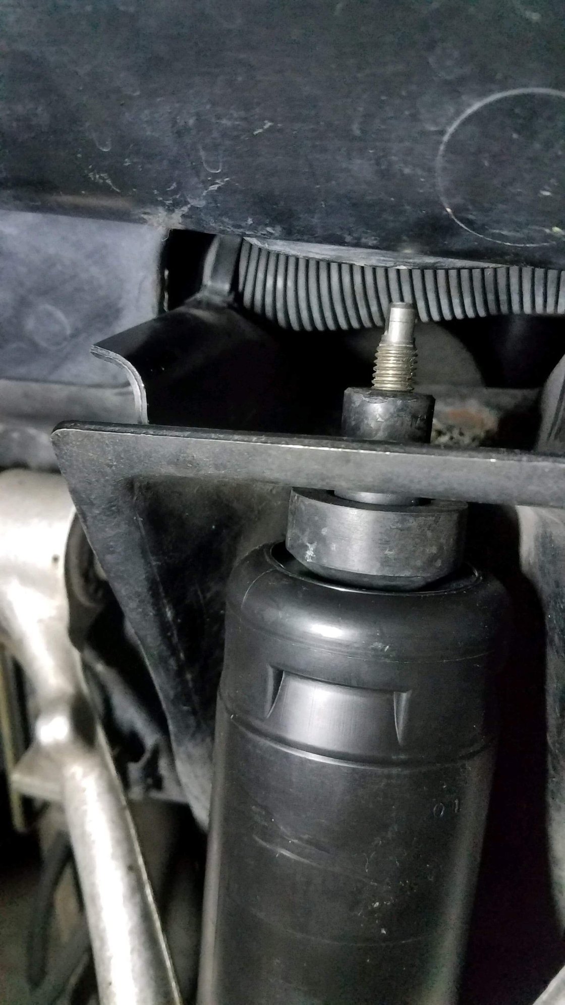

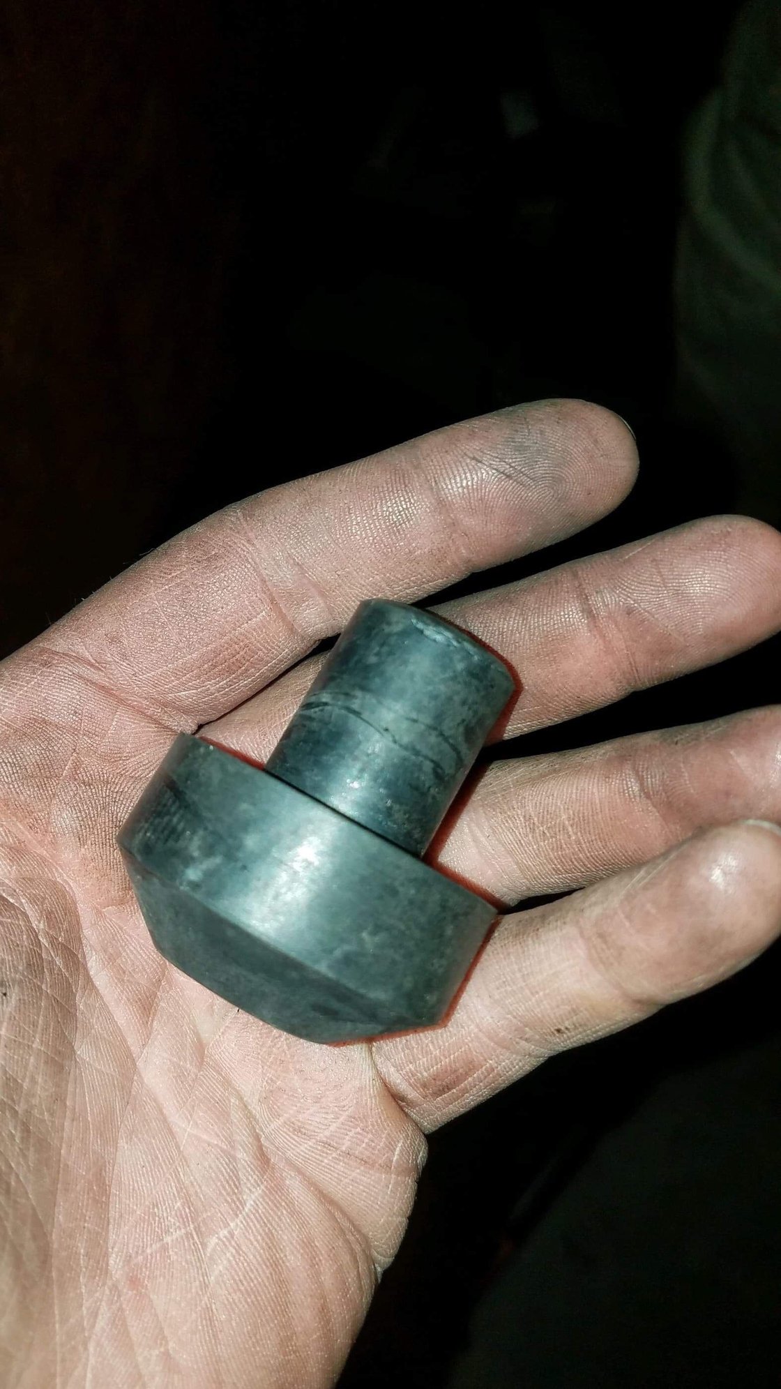

Me and a buddy swapped out my Bilstein sport shocks for a set of c6 z06 shocks last night on my 03 Z06. I made the change mainly because I felt like the Bilsteins were a little stiff for what I needed. The rears went on just fine, no modifications needed and I did not have to reuse the old bushings. I wanted to share this in case anyone puts these on and runs into the same problem I did with the fronts. We took a break and tried to find some info online about how to do the fronts because they were different but really couldn't find much, surprisingly. The rubber bushing on the fronts of the C6 shocks are a different style/shape. Basically the bushings comes up through the mounting hole on top of the shock mount and there is no way to reuse the stock donut shaped bushing and I did not want to just put the factory washer and nut back on because it seemed like it would not seat good with the much smaller c6 bushing. Maybe that is okay to do but I didnt feel like that was the best method. What I ended up doing is trimming about half an inch off the top of the c6 bushing to where is almost sits flush with the mounting bracket, that way I could reuse the stock bushing on top. I appologize for not providing pics but I didnt take any. Anyway I drove about 50 miles home and they did great, no noises and I am happy with the way they feel. It is definately a softer smoother ride than the Bilsteins. I haven't got a chance yet to really test cornering. Anyway just wanted to share in case someone was considering doing this.

Here is a pic of the C6 bushing and one of it installed. Looking at it now I don’t see any reason not to just reuse the stock washer on top but what I did was cut that top part of the bushing down and reused the factory c5 bushing. This pic is before I cut it down.
