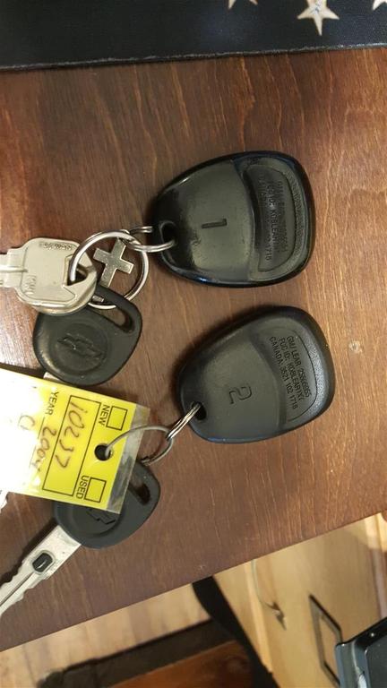

This is gonna be a dumb question but i have to ask.
Does both FOBS have the same part # and are they labeled 1 & 2 ?

They are the same. But they are not labeled 1 and 2. Only in the computer are they designated key fob 1 and key fob 2

Odd, I believe ya brother but mine have an embossed 1 & 2

A little research and it looks like after 2001 the FOBs were numbered #1 and #2. (Based on photos of the backs of pre owned 2001- 2004 FOBs for sale on the infamous auction site. Other members will likely chime in to confirm.
The 99's didn't have numbers. Well mine didn't, nor both of my brothers 99s didn't.

My 2000's don't have numbers either.

Just checked mine and neither have 1 or 2 on them.
Here's what's on the back of both.
GM 10432147
Canada 218 102 108
Model/FCC ID AB00216T
Like I said, one works flawlessly and the other works for awhile before failing.
