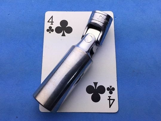

Above. Easy 3 hour job (2.5 hours of that spent getting the 14 year old plug wires off the plugs!). Just did it on my 2004 Z06, this Snap-On socket, while not required, made the #7 cylinder (Driver's side rear) a piece of cake. Only thing I removed was the air tube on the driver's side. I replaced the plug wires with new GM Performance Parts red wires. Remember to use anti-sieze on the plugs and di-electric grease on the boots.
https://store.snapon.com/3-8-Drive-D...t-P642284.aspx

That plug is a killer. Needed a wobble extension shaft to get it. Others were doable with minimum effort. Once you break each plug loose use a piece of vacuum hose to remove and replace the plugs. Easier that way and you will know if you are cross threading when replacing.

Kevin, you're remembering the C3's and C4's. Some of the plugs on them are easier to reach from below.
This the socket I use that makes the job much easier on many of the plugs. (You can even find one on eBay right now for $30 )
Good luck... GUSTO
