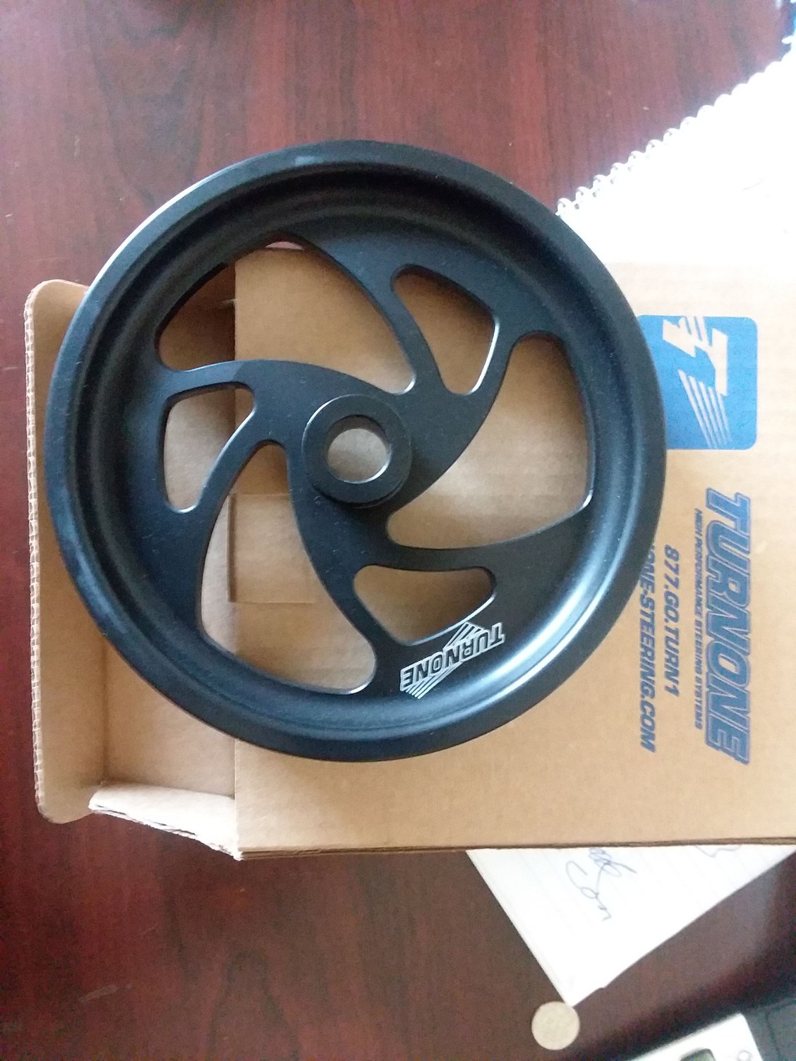

I do recommend the Turn One pulley or C6 pulley if you are changing pumps. The spokes make getting to the bolts much easier.

Its a PIA...the oem plastic pow st pump pulley sucks...I HAVE A TURN ONE PULLEY BRAND NEW FOR SALE...go a few months back for good pics and part # in fs sect.make me an offer...less parasitic draw...liteweight…..
