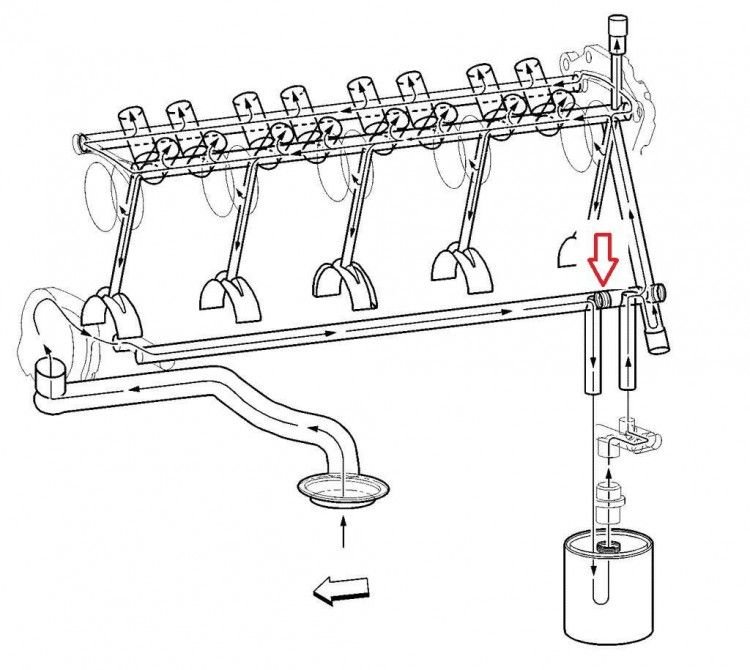

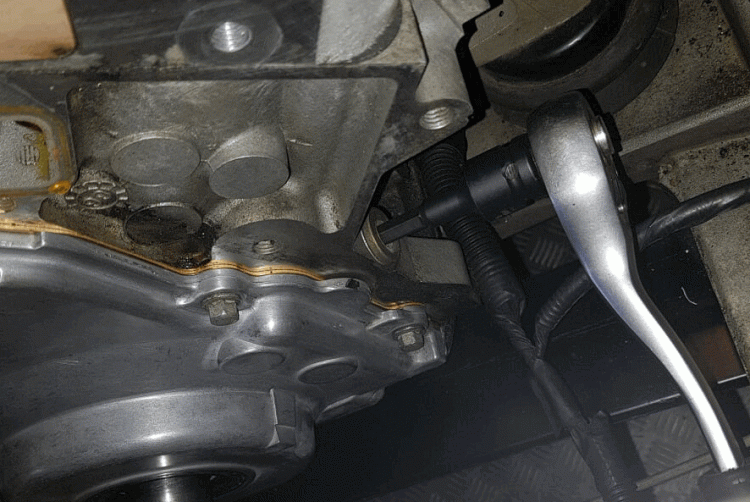

When I replaced my oilpump/harmonic balancer and timing chain i first filled 8 oz of oil in this hole to fill the pump and oil system .
Then I removed the fuses for injectors before I run the starter for approx. 10 sec intervals .
On the second interval the oilpressure build up was OK . Shown on the HP tuner trend (upper white trend)
