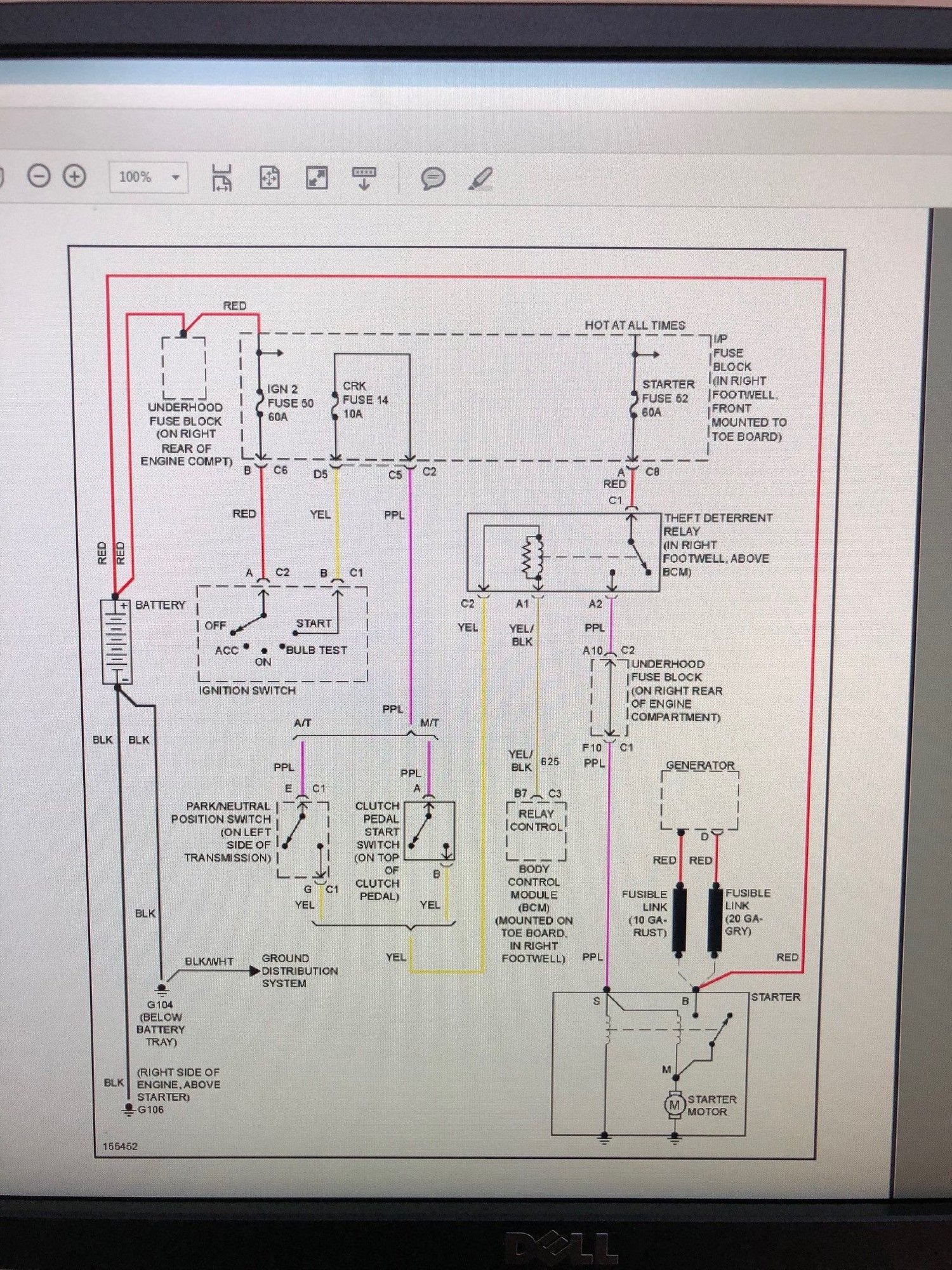

If the test light does NOT come on while cranking on the Purple wire you basically have to work your way back through the circuit to find out where you are losing the juice !!...enclosed is the starter wiring for an 2002 !!
