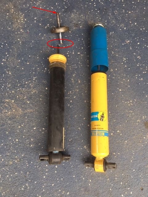

Bilstein B8...

I plan to upgrade once my stock ones get too bad. Besides the cost of the shocks, what's a shop estimate for the install?

Not sure what a shop would charge but I did mine myself, it’s not hard.

Be careful what you say - on mine both of the top nuts on the fronts rounded off/broke and I had to use a Sawzall to get them off!
