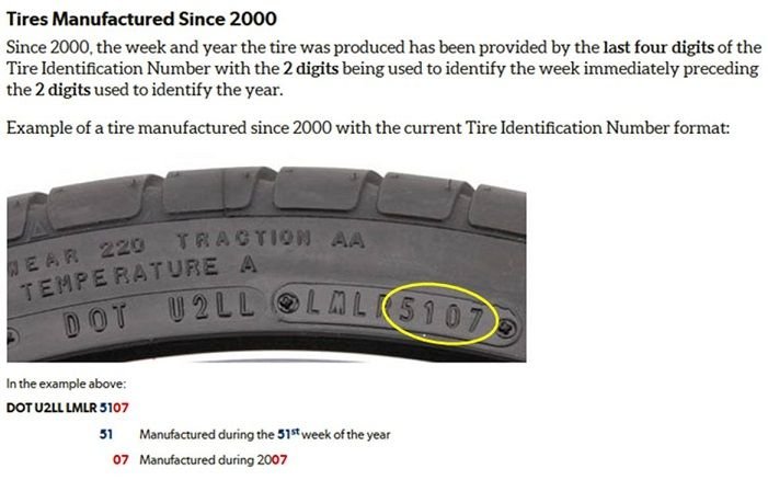

By all means check the date codes on your tires. The Goodyear Supercar tires are awesome on these cars when they're new. But with enough heat cycles they will lose a lot of their grip. If they're over 6 years old, you will never experience the real potential of your Z06 with these tires. They my not be unsafe, but they will not have the grip your car needs.
Tires Manufactured Since 2000
Since 2000, the week and year the tire was produced has been provided by the last four digits of the Tire Identification Number with the 2 digits being used to identify the week immediately preceding the 2 digits used to identify the year.
Example of a tire manufactured since 2000 with the current Tire Identification Number format:
