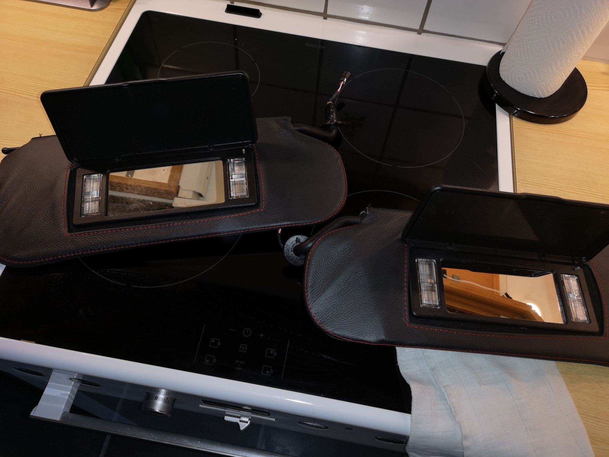

These photoes show how I did it .
Checking polarity
Gluing the pieces together
Ready for installing back in to the car
