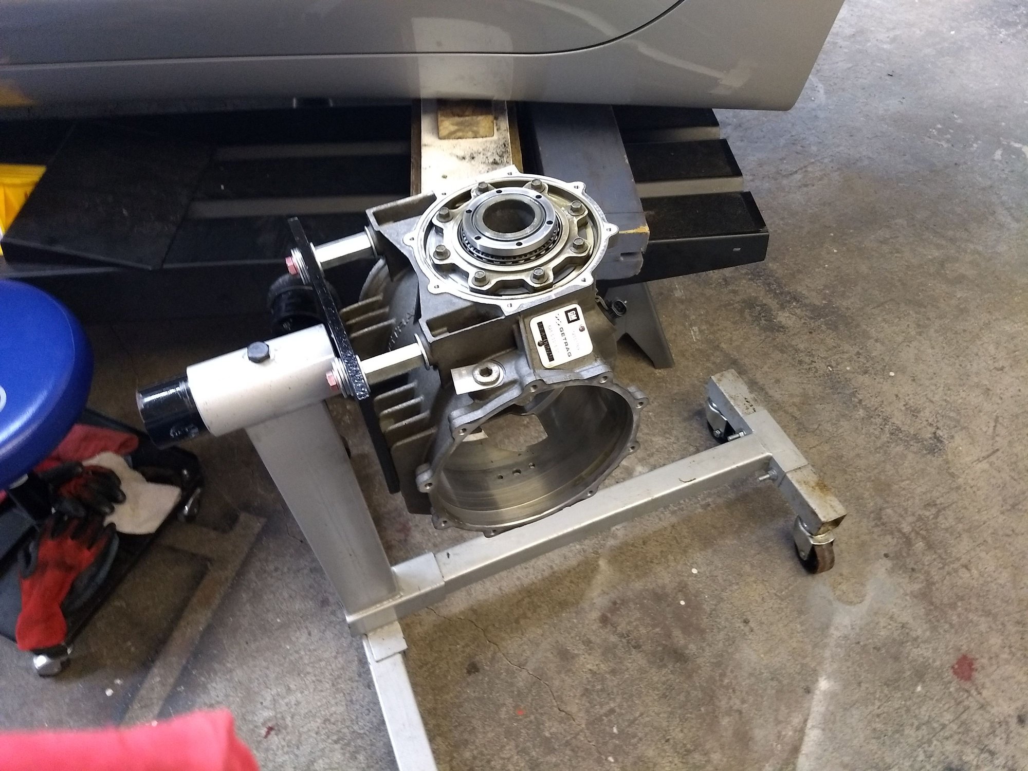

I found both tool kits for c5 diffs on ebay. Both are complete. J44616 for 275 and j42618 for 100. I have dial indicator access through work, aircraft maintenance. The only tool I don't have is the holding fixture with the handle. Do I really need it?
Old Feb 26, 2019 | 09:58 AM
Pounder's Avatar
Pounder
1/4 mile/AutoX
Joined: Jun 2014
Posts: 11,439
Likes: 2,184
From: Buffalo Texas
I used a engine stand !!!

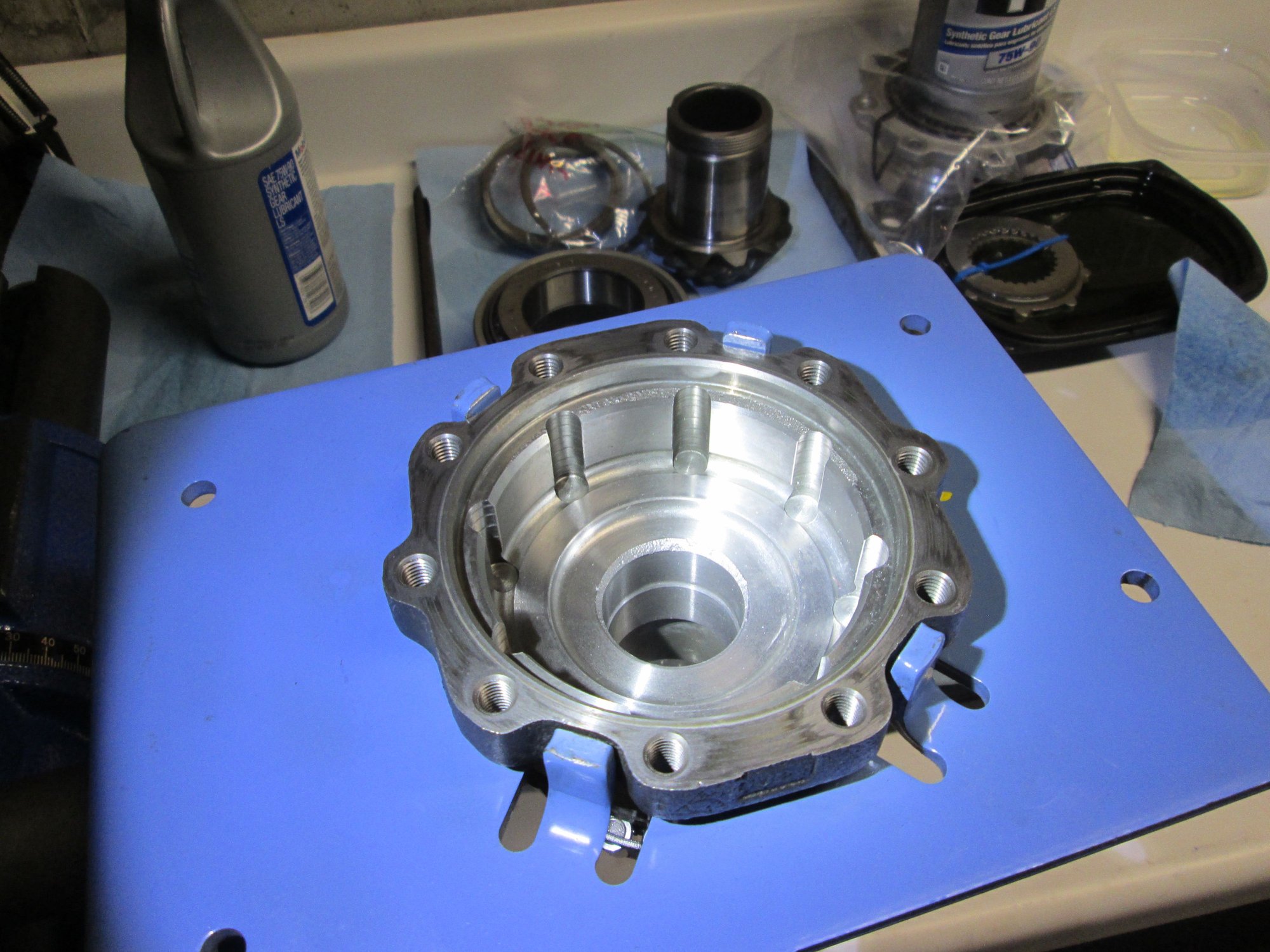

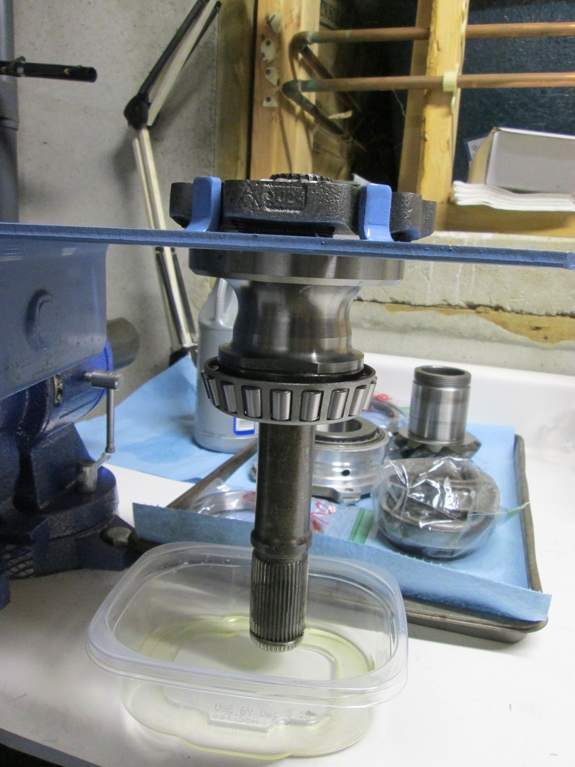

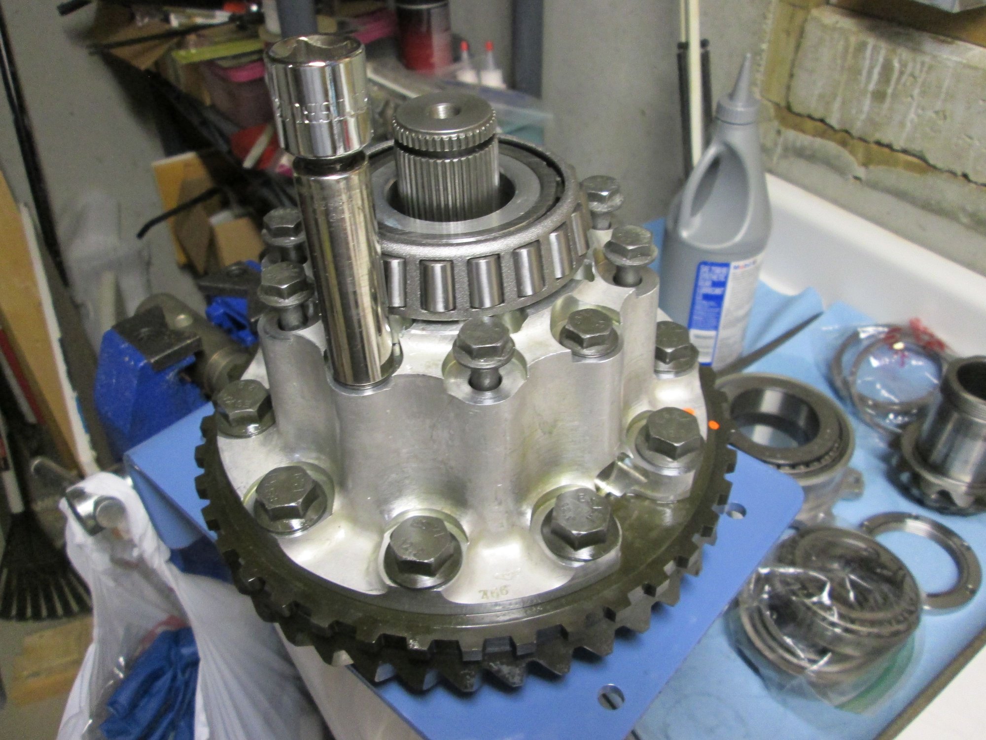

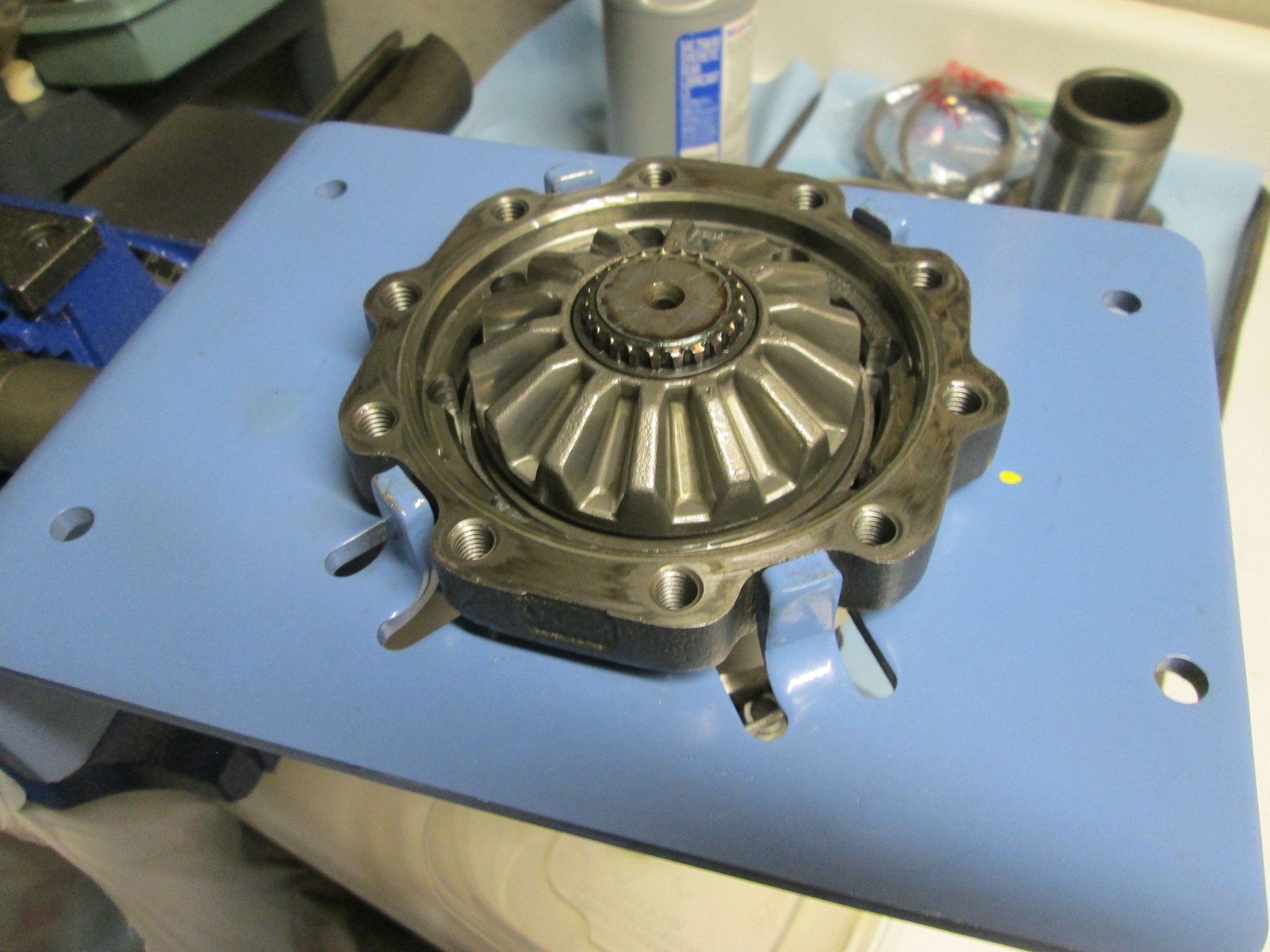

Old Feb 26, 2019 | 07:49 PM
69's Avatar
69
Joined: Nov 1999
Posts: 2,343
Likes: 854
From: MI
Cruise-In VI Veteran
The holding fixture servers two purposes, you can get away without using it to disassemble the diff, but it fixture is great a holding tool to split the spool and remove the ring gear and to hold the spool during torqueing of the ring gear/spool bolts...A few pics of my tool clamped in a bench vise.
Cheers
Goose
