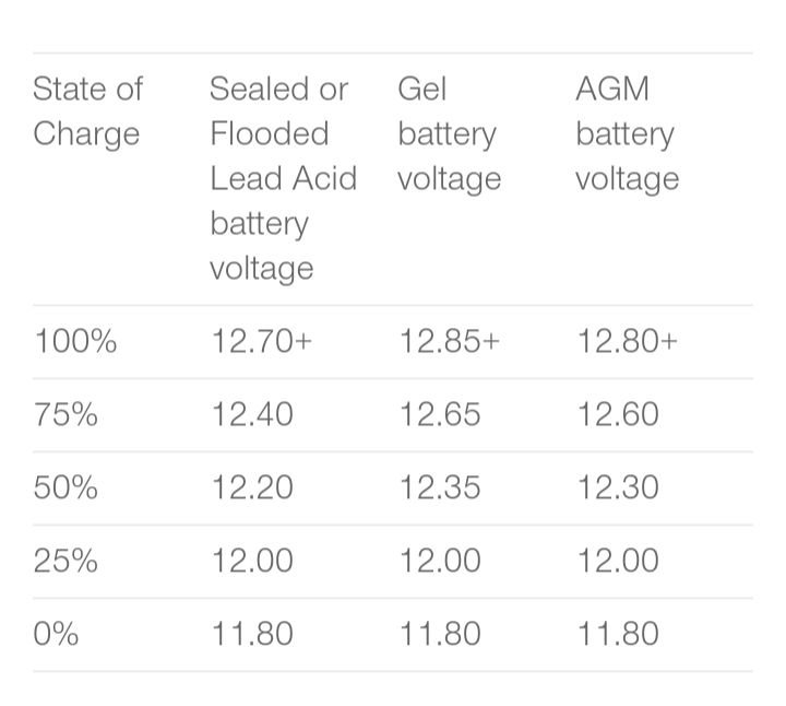

Old Feb 27, 2019 | 01:17 PM
Robrote's Avatar
Robrote
Joined: Aug 2017
Posts: 958
Likes: 177
From: Newark Delaware
