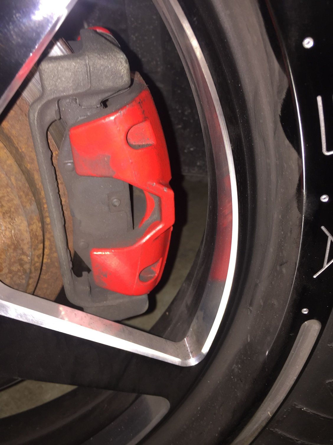

I run them on mine but I’m running smaller rear brakes up front so I’m not much help, from the center of wheel to inside lip is roughly 7 1/2 inches, you might be able to measure center to outside caliper and get somewhat of an idea, I also run them on a 12’ zl1 with huge 6 piston calipers but with 1” adapter so they’ll definitely work you just may have to space them slightly to make them fit
