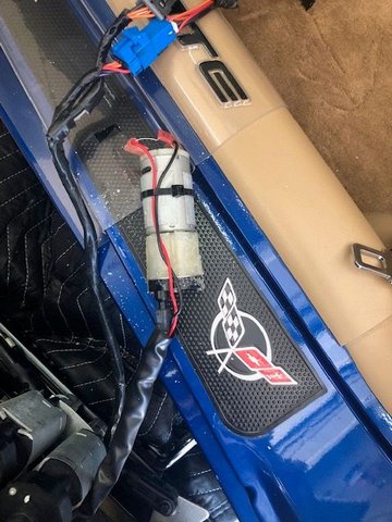

So. Finally removed the seat to try to address this issue. Before I get into the wiring checking here's what I found. The switches for both lumbar supports and the switch for the side bolsters are dead. However, when I unplug the air hose from the motor the motor starts running. As soon as I disconnect the hose it stops running. Could it possibly be a bad motor? I attached some photos for what it's worth.
