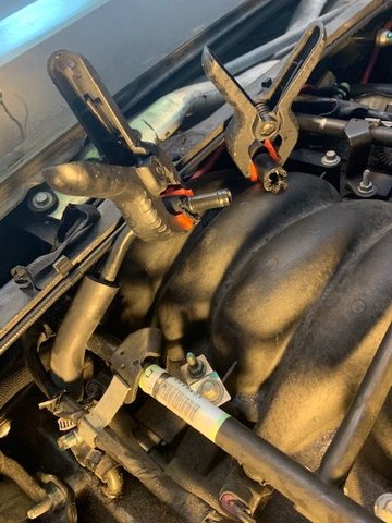

is it possible to have a oil leak from the hose i have posted with the clamps on it?
it was broken apart. thanks in advance

Yes, part of the pcv system

YES..You will need to purchase a PCV ASSEMBLY

Check out post 9 in this thread. That is the rubber y that rots away. You can use this push lock air fitting to fix it, all you have to do is cut the bump off of the end of all 3 tubes and push them into the fitting. Be warned the car will run like **** if you don't disconnect the battery to reset the computers. Good Luck, I will see if I can find where I got the fitting from but they are not expensive.

Also found this but can't seem to find where I purchased the part.
