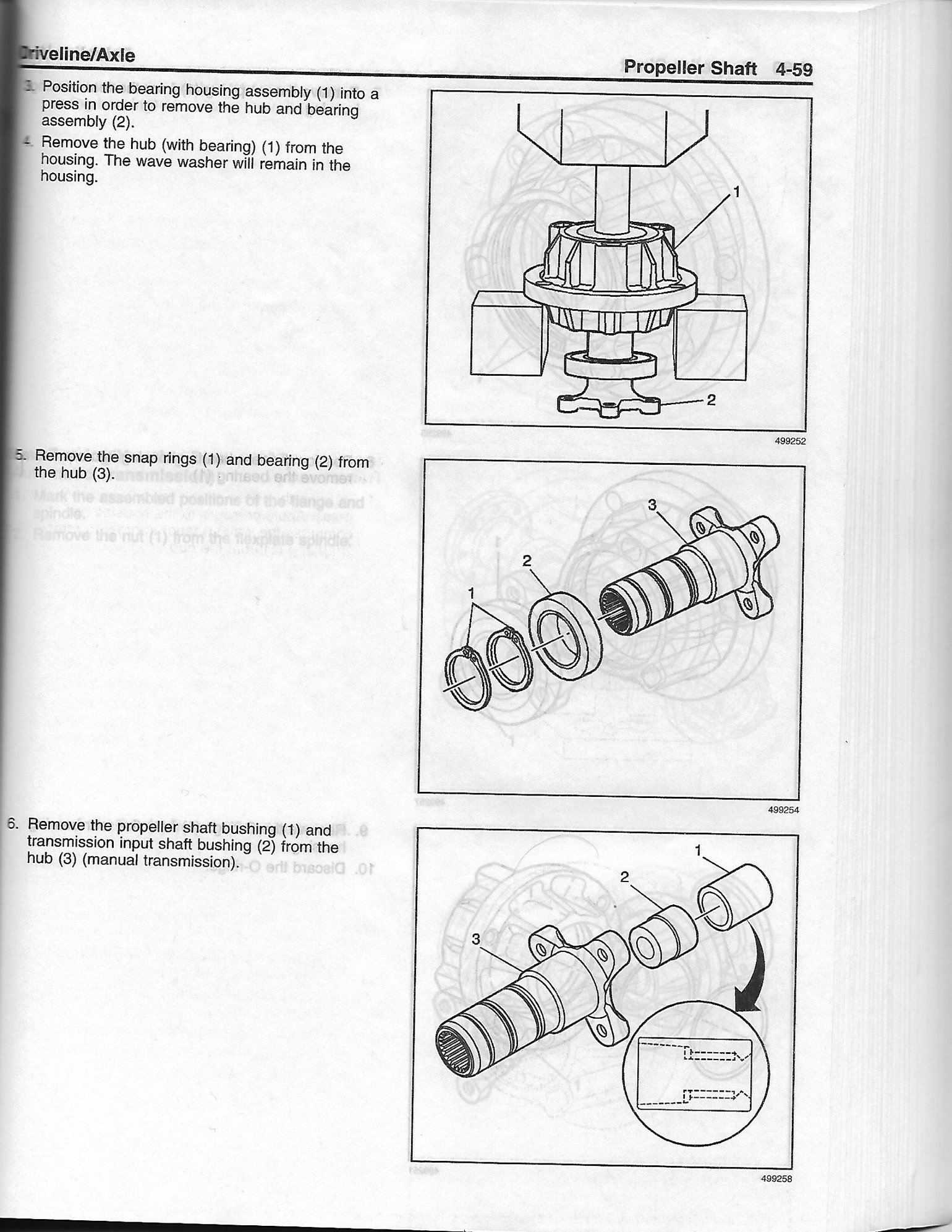

Originally Posted by Toys4Life C5
I hope your are right.... but the bearing closest to the coupler is loose enough that the race will actually spin on the shaft. It is supposed to be a press on fit so that the bearing will spin between the inner and outer race. If anyone knows the specs for that shafts minimum diameter I would love to mic it and see for sure. I suppose I could have had a defective bearing (too loose) that would be very unlikely.
If anyone with a GM service manual knows the specs for that shafts minimum diameter I would love to mic it and see for sure.
I have a shop manual, and just took a look at it. There is no mention of dimensions, for that spindle. HOWEVER, there is mention that after pressing the spindle from the housing, you "remove the two snap rings, then slide off the bearing". If you can, and/or are supposed to slide the bearing off simply by removing 2 snap rings, then I would suspect that the bearing "floats", similar to the older cars that had brake rotors with inner and outer bearings, riding on the spindle....No??
Without the parts in front of me, it's a little difficult to picture.
Thank you for taking the time to look this up in the service manual! Any chance you could take a pic of the page in question and attach? Logic tells me it is a pressed fit, but from what you wrote above, it sounds like it slides off the shaft.

Does this help?
Leadfoot 4 - that helps a TON - thank you!
Since I am going to keep the C5 for a long time, I need to invest in a factory manual. Where did you purchase yours if I may ask?
Sorry about the "flopped" images, but that was the only way to get my book situated on my scanner. With respect to the manuals, I seem to recall that Helm Inc was still the supplier of GM shop manuals, back when I bought my car, in 2001. I got the manuals right after I bought the car.
