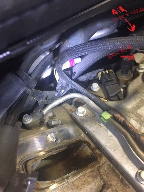

The secondary air system is completely separate from the intake manifold. The air system has two check valves, one of them is bolted to the drivers side rear head. If you are going to keep the air system, it wouldn't be a bad idea to replace this $24.00 check valve because you can only get at it with the intake off.
If the system is throwing codes and or you will be doing headers, then it will be a good time to remove it completely because that is accessible with the intake off.
I just did this a few months ago, I left the air system in and replaced both check valves.
Old Apr 2, 2019 | 11:27 PM
pjdbm's Avatar
pjdbm
Joined: Mar 2017
Posts: 1,485
Likes: 343
From: Long Island New York
He is the rear air check valve that is attached to the drivers side head
