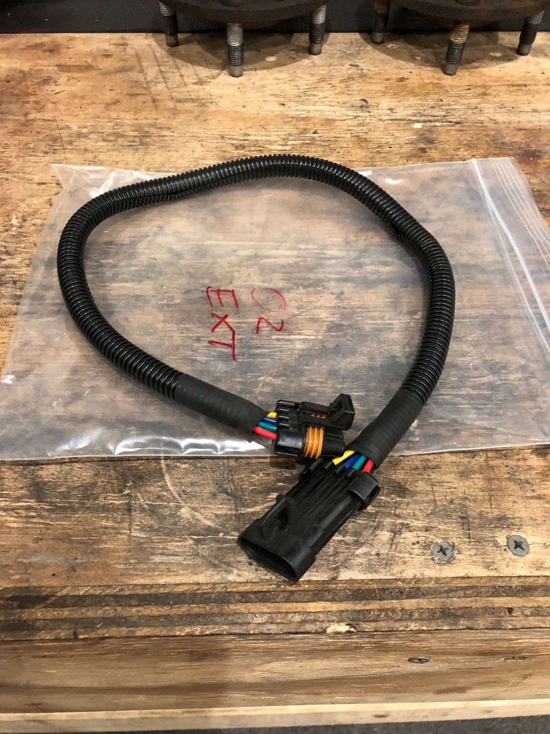

Hey guys, so I stopped receiving data from my upstream 02s and i went and checked and my wires are friend from touching my LTs. Before I cut and splice into the harness, is there a plug and play harness that I could buy? When I look at the wiring system, I have my 02 sensor that connects to the harness and another connection that connects to the main harness. Where could I purchase this harness? My car is a 2002 ls1 with an LSA blower.

If I’m understanding your situation properly, it’s the harness extension portion that’s burnt? If so, there are several header companies that sell O2 sensor extensions. Better yet, I have one from my header install that I never used...let me know if you want it! $25 shipped. Just make sure you validate it’s the right connector type/shape. It’s the straight 4 pin plug, not the square style.
If its it’s the main harness portion before the extension that’s toasted, I believe your only option is cut/splice/rebuild.
