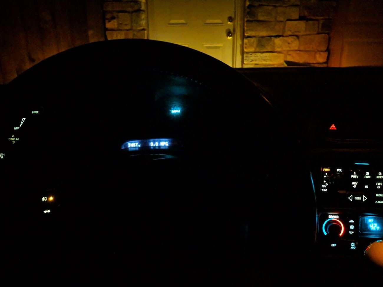

I am looking for help. I've solved every major issue with my 01 other than the cluster lights. When I first got the car the cluster lights were dim and HVAC lights were mostly out. Had HVAC rebuilt and all is good there. One night I noticed that my dash lights were out but the DIC and everything else was fine. The light s being out was accompanied by an obnoxious "buzzing" coming from under the dash. One of the other issues is a non existent light/key chime....just a strange clunking sound. In addition I noticed that when I clicked my on my parking lights the headlights would pop up and not illuminate but would illuminate if I clicked them on. This buzzing is always there, lights on or not. I have cleaned the grounds under the hood, which were pretty clean to start with. The HUD works fine,too. If you look in pic you can see the headlights are up and fog/running lights are on in the parking light mode.

By your description, this looks like multiple issues.
From your picture, it seems you are also missing the DIC buttons lights. Since you have lights on the HUD buttons, it might be that the little lightbulbs for the DIC buttons are blown (3 bulbs, 6 buttons: there is 1 bulb every 2 buttons). You mentioned that at the beginning they were dim, so it could be that only 1 was good and it finally went belly up.
As for the IPC lights, that comes from 2 black light tubes at the sides of the cluster (1 per side). They require high voltage and there's a special power supply just for that, attached to the back of the IPC. The buzzing sound you are hearing might be a symptom of failure from the high voltage power supply.
The IPC has several connectors, it could also be that one of them is not fully seated.
The issue with the parking lights and the headlight doors might be a faulty multi function switch (MFS). It is a known point of failure.

Thank you for replying. I think the DIC control buttons work but will check tonight. I know the little down lights in the mirror are not working. Is there a light around the ignition switch? I can never find that thing in the dark either. I am the type of person that if I am going to pull the cluster all the lights and power supplies will be replaced and all the grounds & connectors will be cleaned. Are those light tubes and power supplies still available?

I didn't mean that the DIC buttons were not working, what I meant was that they were not lit in your picture and that probably the 3 little lightbulbs behind the buttons were blown.
Regarding the black light tubes and high voltage power supply, try contacting Marc (VettNuts) here in the forum or email him (marc@vettenuts.net), but I would suggest to remove and inspect the IPC first.
To remove the cluster you can follow the Vette Essentials installation tutorial for their aluminum gauge bezels.

All lights on the car work as they should except the little down lights and the dash cluster. The DIC control button lights all work but cannot be seen in the pictures. I think I will start with a new multi function switch then a cluster rebuild. Found a company to do the cluster rebuild for $435.
