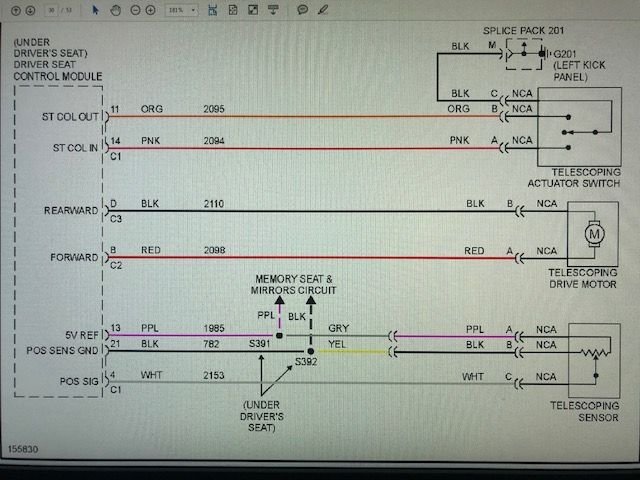

Today my (2004) telescopic steering wheel died. Does not work manually or from "memory" . Is there a fuse involved or is it more serious. Thanks, Bob C

There are 2 "battery" fuses that feed the driver seat control module but if your seats work it's probably not those fuses. This is a wiring diagram for a 2002. I'd actuate the switch and see if you're getting power to the telescoping drive motor. As you can see there is a body ground G201 which should be checked !!
