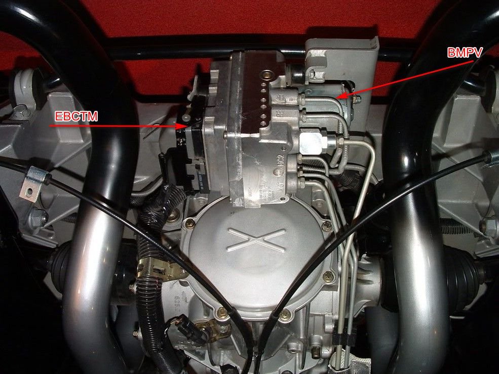

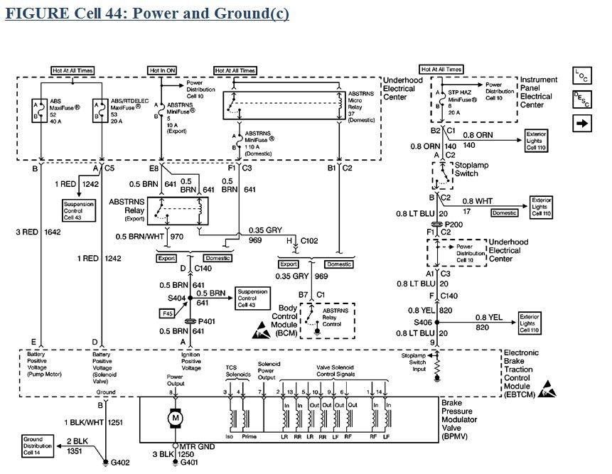

I would make a suggestion if you do change the CMP sensor you not only check the wires visually but do a signal integrity check...12 volts, ref. ground and the signal...also with those “U” codes I’d check the EBCM power and grounds first before even thinking about replacing it...your ‘97’s EBCM is located at the rear end so I don’t think the wiring could have been affected where you were working !!

Where is the ecbm located so I can check the ground? Probably wouldn't hurt to clean them up

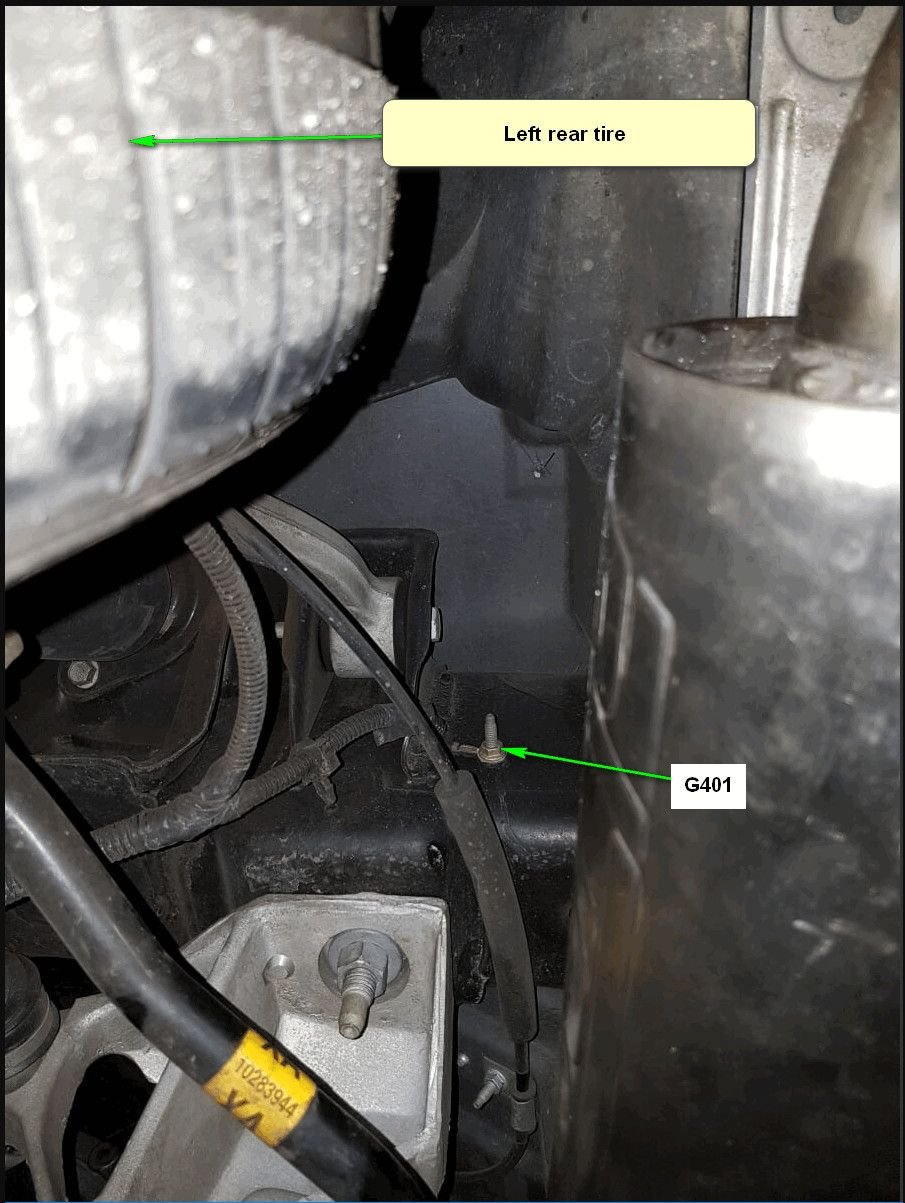

I hope this helps you
On your 97 there is supposed to be two grounds G401 og G402 .
As far as I know the G402 is located on the frame but on the opposite side(right) of the car compared to the G401 location .

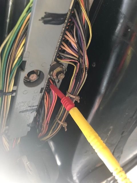

Hi !!….if you have a voltmeter we can try this to see if you have a crank signal during start....back probe as pictured and connect red lead of voltmeter to pin 62 (light green wire) at the C2 connector...PCM pins are numbered !!...connect black lead to good ground....crank the engine and you should see something similar to my video of cranking over my engine with a good crank sensor...you should see similar voltages !!...if no voltage the CKP wiring and sensor will need to be checked !!
