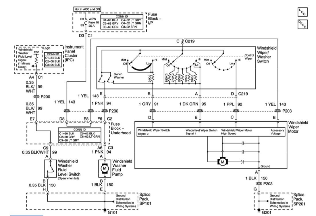

Hi,
I'm a new member and I have a question for the group. I have a 2002 corvette and the washer fluid is not working. I have two pumps,both not working, I verified the positive and negative lines are going to the correct posts, the fuse is good, and the water lines are clear, i also have 12v when the button is pressed, and the float sensor works. What else could it be??
Thank you

Check the ground G101 and the splicepack SP101 for bad conductivity .
