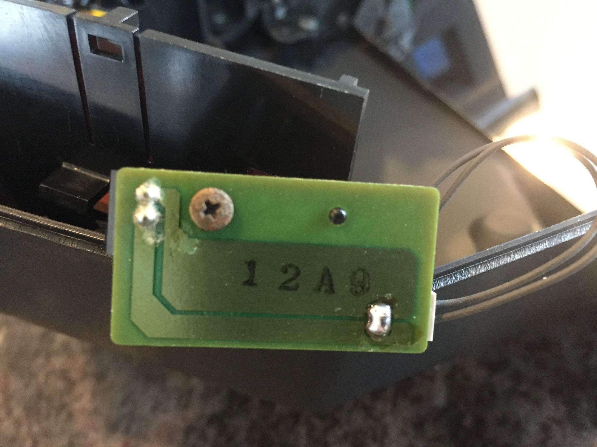

I have seen posts by others here of dimming displays and saw a repair on video of bypassing the light sensor (photoresistor) in the HUD unit to correct a failure of that and restore the display. It bypasses the function of the resistor (to change the light intensity from day to night) and lets you control the brightness of the display with the control for the HUD alone.
So today it bit the bullet and took the dash off and removed the HUD unit. The wiring harness was a little stuck in the IPC (dash console) but came out OK with a little back and forth wiggling and gentle pulling. I seriously doubt if I pulled any wires out of the harness plug. it came out clean and everything seems solidly connected inside the plug.
I took the HUD apart and soldered the connections on the back of the little board for the photoresistor (on the diagonally opposite corner from the photoresistor) together, like shown in the repair video. I touched nothing else. I closed it up and then reconnected it to my dash and now I get nothing, no display, no mirror movement, no response to any of the HUD controls. Before I took it all apart at least I had appropriate mirror movement. I also checked the harnesses going to the IPC and to the HUD controls and they are solidly connected and I never touched them either,

There basically is no circuit board. only a direct path from the sensor to the connected wire on the opposite side. There are no electronic components to that item.
Here's a pic of the back of the board where I soldered the 2 contacts together, seen at the lower right corner.
