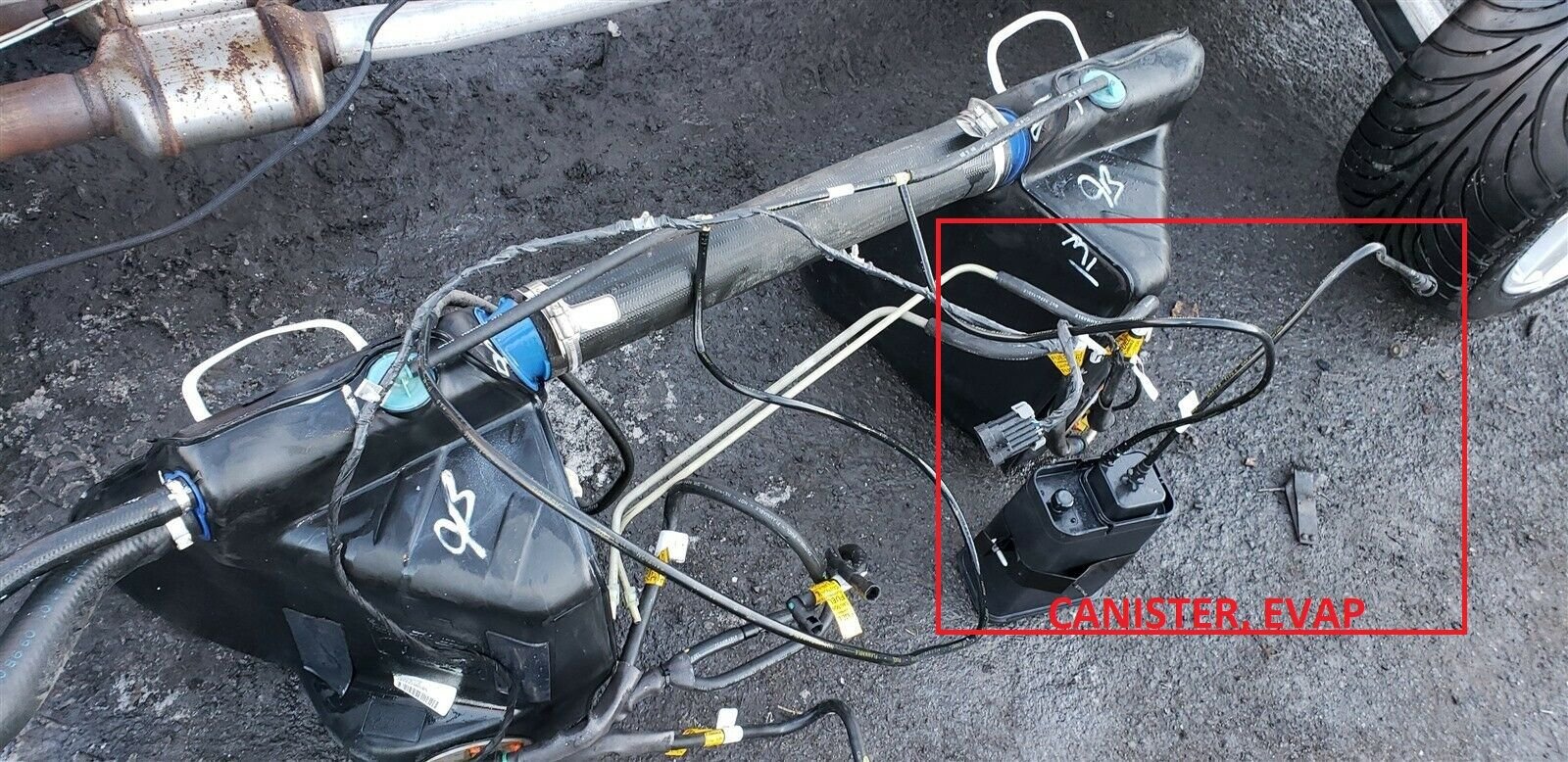

Originally Posted by 69
Well here's the thing. The next day after he dropped the car off i started to get traction control / abs codes. The code was for RR sensor fault. so after a couple weeks of resetting i decided to take a look at the sensor and i saw the wire was frayed , so when i took the tire off to fix the wire i saw that tube for the first time. Since i fix the wire i don't have anymore codes popping up. So what ever this is for it's not setting off any codes. Or i might have to go through so many cycles to set a code but so far nothing. I put over hundred miles already. Here's where i found the stuff. It's in front of the rear tire. Since the liner is gone i stuck my hand down in the rocker and pulled that stuff out. I was looking for mabey a hose or somtehing that could shine light on where that tube connected to. But i just found the damaged parts.
Upon removing the right rear wheel and wheel house liner, you may see the scope of the damage...I suspect you may find that the Tank Vent Lines are damaged to include the CANISTER, EVAP unit badly damaged....Boxed in red below
Pic of a 1998 fuel tank and EVAP...
[/QUOTE]
The inner liner is gone. Its wide open. If there was something there it's all wiped out. Where is that canister located??

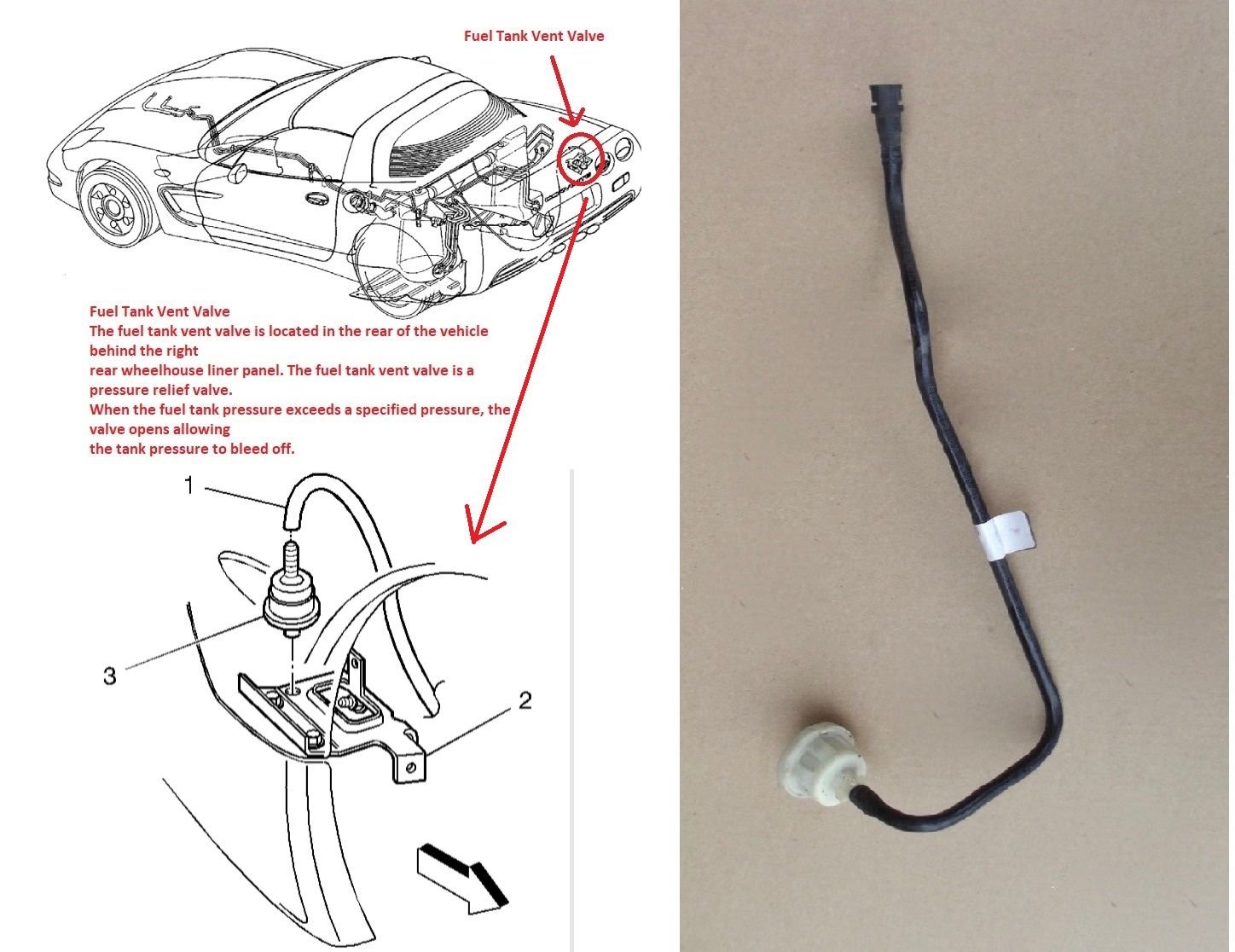

Vent Valve location behind the wheel house towards the rear of the car, for the EVAP Canister access, need to drop the right fuel tank
Goose
Old May 7, 2019 | 06:53 AM
helga203's Avatar
helga203
Joined: Jul 2010
Posts: 6,013
Likes: 726
Goose
Yeap that's it. Thank you goose

Well with the help of 69 [ goose] he found one on Ebay and I just purchased it. It will be here Friday. Wow what luck. Thanks very one for your help. since I'm going through this bs I'm going to tell my friend the part and to fix it was 300 bucks.
Part was 28 bucks
