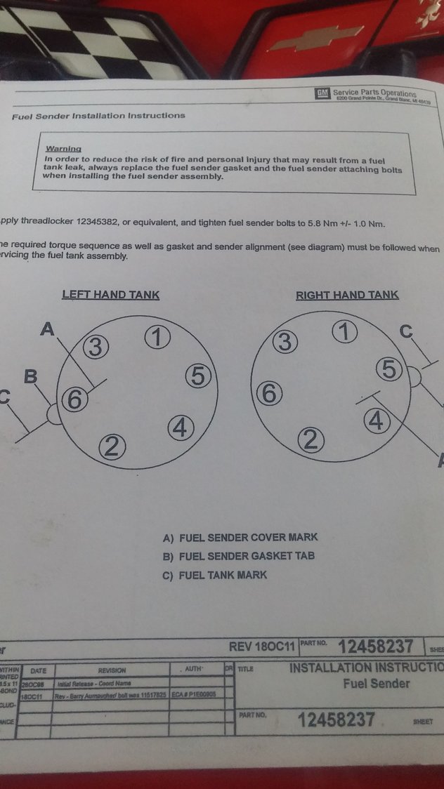

I know this is an older thread but for anyone else looking for the torque specs they are 5.8 nm +/- 1.0 nm.
There is a torque sequence as well. I will try to post a picture shorty.
