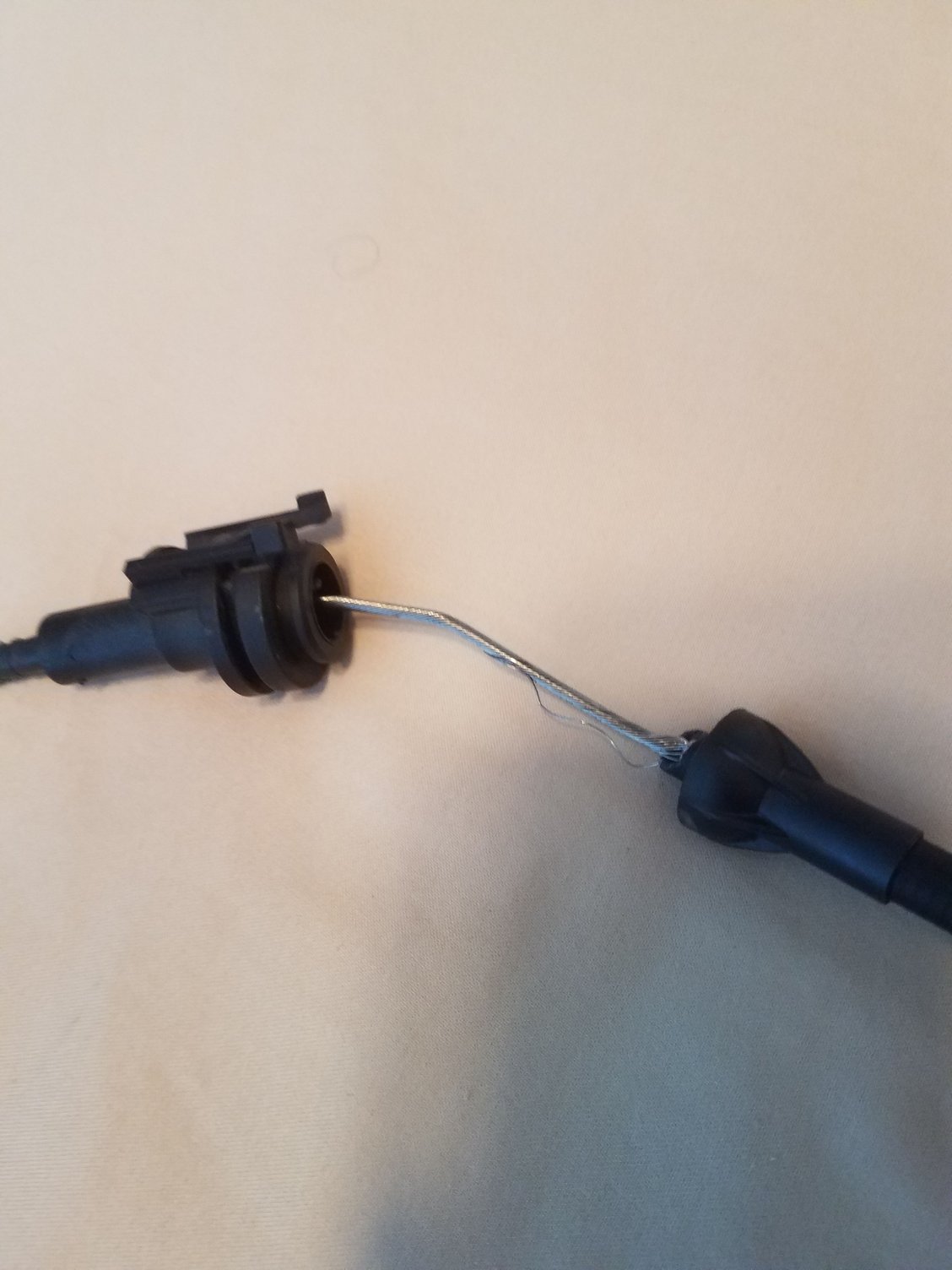

Default Update c5 shift cable pics
Here are some pics of c5 shift cable that I had replaced. Final cost $800 OW.
PIC 1 CABLE UNBROKEN
PIC 2 CABLE BROKEN
PIC 3 CLOSE UP OF WHERE IT BRAKES
PIC 4 CLOSE UP OF NEW BUSHING
Probably should have called transmission repair facilities to get a number of quotes before taking it to chevy dealership. Expensive lesson for a part that costs between 50 and 90 dollars from advance. Auto zone, napa or rock auto. I had limited time to have it repaired so I paid the price. Call around it's worth if your not broke down on the road or other circumstance that you need the car.

I actually watched a video of a c6 getting that cable replaced. It broke in the same spot. It was a good deal of work to get at it. Drop the exhaust, the tunnel plate, trying to get hands up under the car to get to that cable bracket......So it is a PITA job and does take a bit of time.....Still a bit much at 800 bucks....Did they explain why exhaust bolts cost so much? The exhaust has to come down as part of the job so what is does the extra 200 cover???
