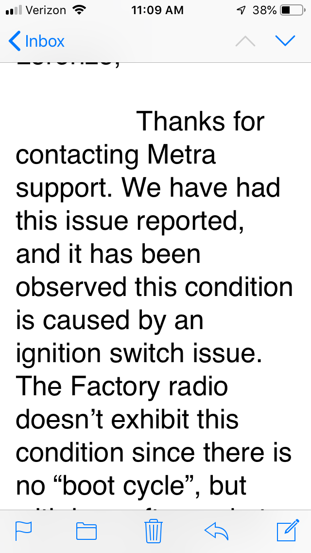

Have you tried contacting technical support at Metra? It seems this is not an isolated issue and it would be interesting to see what they have to say about this problem.
Old May 19, 2019 | 11:08 AM
lavaheadache's Avatar
lavaheadache
Joined: Oct 2017
Posts: 85
Likes: 27
From: Cape Cod, MA
2018 C5 of Year Finalist
I will be calling tomorrow and will report back to this thread.

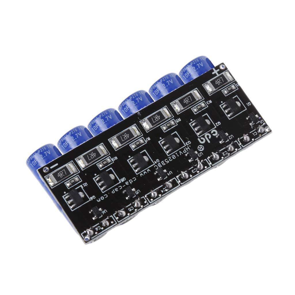

That was my observation above in Post 2:
It seems that the Accessory Switched power output wire from the AXXESS (red wire) that goes into the headunit is briefly interrupted when the ignition switch is transitioned from ON to Accessory. In addition to that, it also seems there is a delay for RAP to kick in when going from Accessory to OFF, which causes 2 reboots in a row.
What would be good to know is whether this brief interruption when transitioning from one position to the other is inherent to the switch design, or if it is caused by wear-and-tear and therefore "correctable" by replacing the switch.
Otherwise, I already mentioned an idea that perhaps could work. Again, the Disclaimer: I haven't tested it, so swim at your own risk
The goal would be to provide a way to keep the Accessory Switched power to the headunit alive, just for the brief moment that it goes down when the ignition switch transitions from one position to the other. This way the headunit wouldn't go OFF and then back ON. If you connect a large car audio capacitor to the red wire between the AXXESS and the headunit, it might be able to do that.

Now it works all the time. The music/sound/unit never cuts out, no matter if you are turning the key, low RPM, cranking the engine, etc. When I get out of the car it keeps playing for 10 seconds maybe. It's kind of neat to hear the music as you walk away.
Edit...also my ignition switch was new so that was not any part of it. The real issue was the AXXESS and/or C5 momentary voltage cut/sag causing the unit to go into the "2 second boot" standby mode. Adding the cap solved all issues.

Beer:30, that’s a neat little cap pack btw, where did you get it?
amazon?
Amazon Amazon

Yes I got it from Amazon. It ships from China.
To install I soldered a lead to + and -. Connected the + to red wire and - to black feeding head unit.
I board is probably a little smaller than a credit card but and less than an inch thick. I just wrapped it in electrical tape to avoid any ground short and left it back there with the bundle of wires.

Jim,
It's basically the same, just different wording.
Let me try to clarify this a little:
  • The capacitor bank has 2 terminal pads to solder wires: one (+) and one (-). I suggest you do that with a red and a black wire, to avoid confusion, and allow enough length to be able to position the capacitors where you want.
  • The AXXESS adapter has a red wire (ACC Switched Power Output) that is spliced to a red wire from the aftermarket headunit (ACC Switched Power Input). Connect the (+) red wire from the capacitor bank here.
  • The remaining connection is the (-) black wire from the capacitor bank. It goes to ground, but the best way to do it is to splice it to the black wire (ground) that goes from the AXXESS to the aftermarket headunit.
Hope this helps
