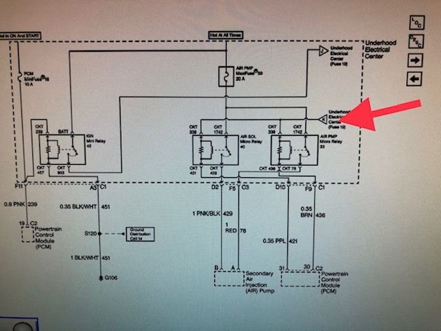

Here is the schematic for the '98...like I said see if you have power to the purge solenoid and skip shift solenoid !!...you may be losing power to both !!...see if you have power to the pink wire at the MAF sensor key ON !!

So i went and poked through my fuse box, and the 20 maxi fuse was gone, which will 100% cause the light. Drove it around for probably 15 miles and the light hasnt come back. Was shown as pending, but it may take a few key cycles to clear it. Cc fuses look good.
