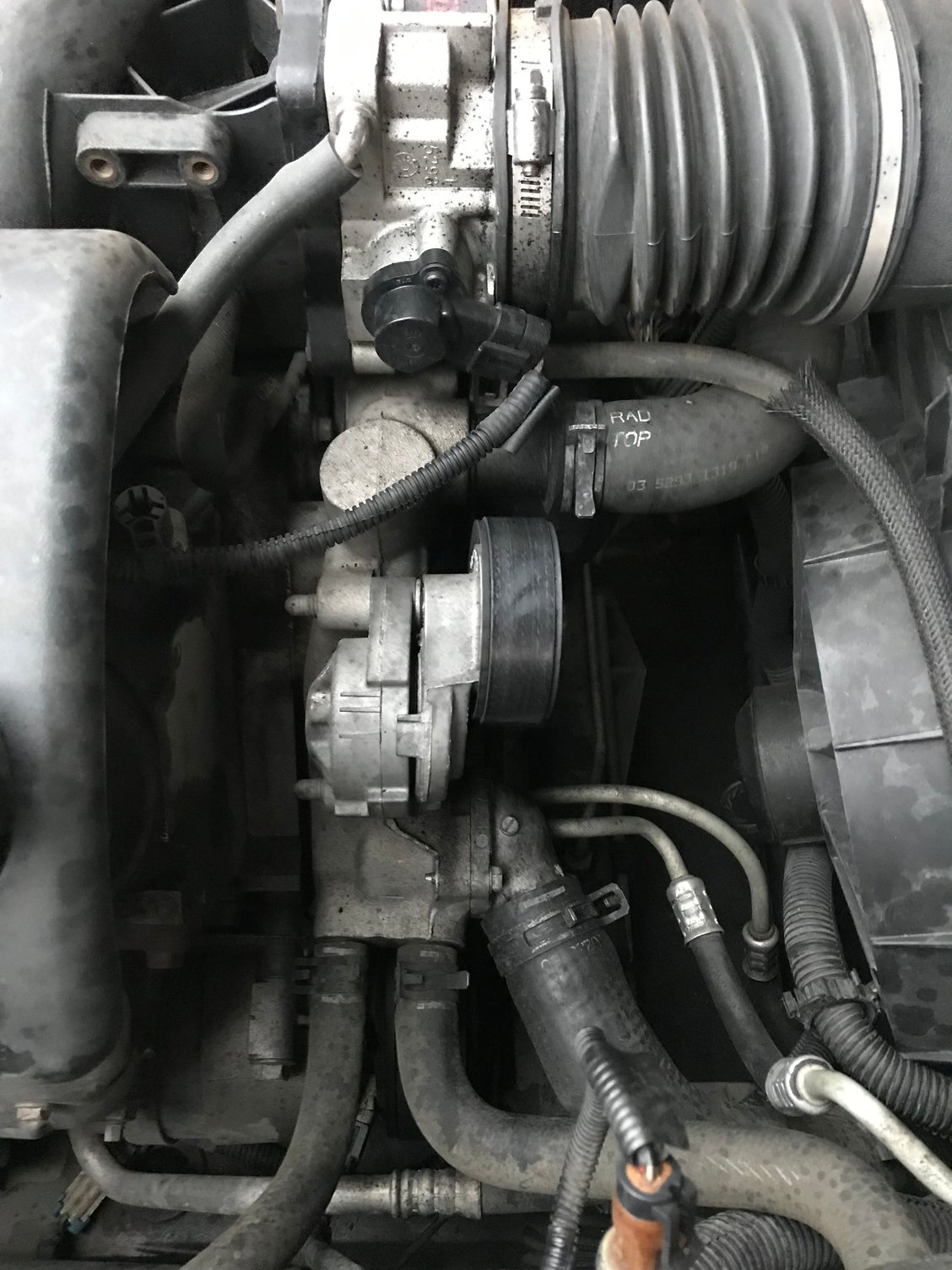

My car is squealing when I accelerate i know Or think it’s the idler pulley what do you guys think it is???
There seems to be a crack or an opening in between maybe that’s why it’s causing the squealing it shakes a bit when I accelerate

When was the last time you changed your belt?

From the picture I would be changing all the tansioners and pulleys and the belt. The tensioner on the water pump is close to falling apart.

ive never changed the belts, i guess its time...

Thank you i just bought the belt tensioner right now getting it installed monday...

Get good quality belts like Gates, don't go for the cheap stuff.
