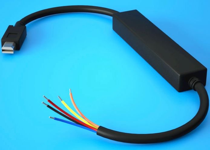

Ok so got this unit installed however I called aem to ask them why the channel disappears? I guess I need a 0-5v module something that gets wired into the hpt! Does any one know what this is or where I can find it.

I'm not sure about the new hptuners mpvi but the older one I have has a plug that goes into the side of the mpvi, this is the inputs for your gauges and whatnot... the gauge should have a single output wire which you insert into the plug that goes into the mpvi... once that is done you will have to add and configure the gauge in the scanner according to which slot you used in the plug

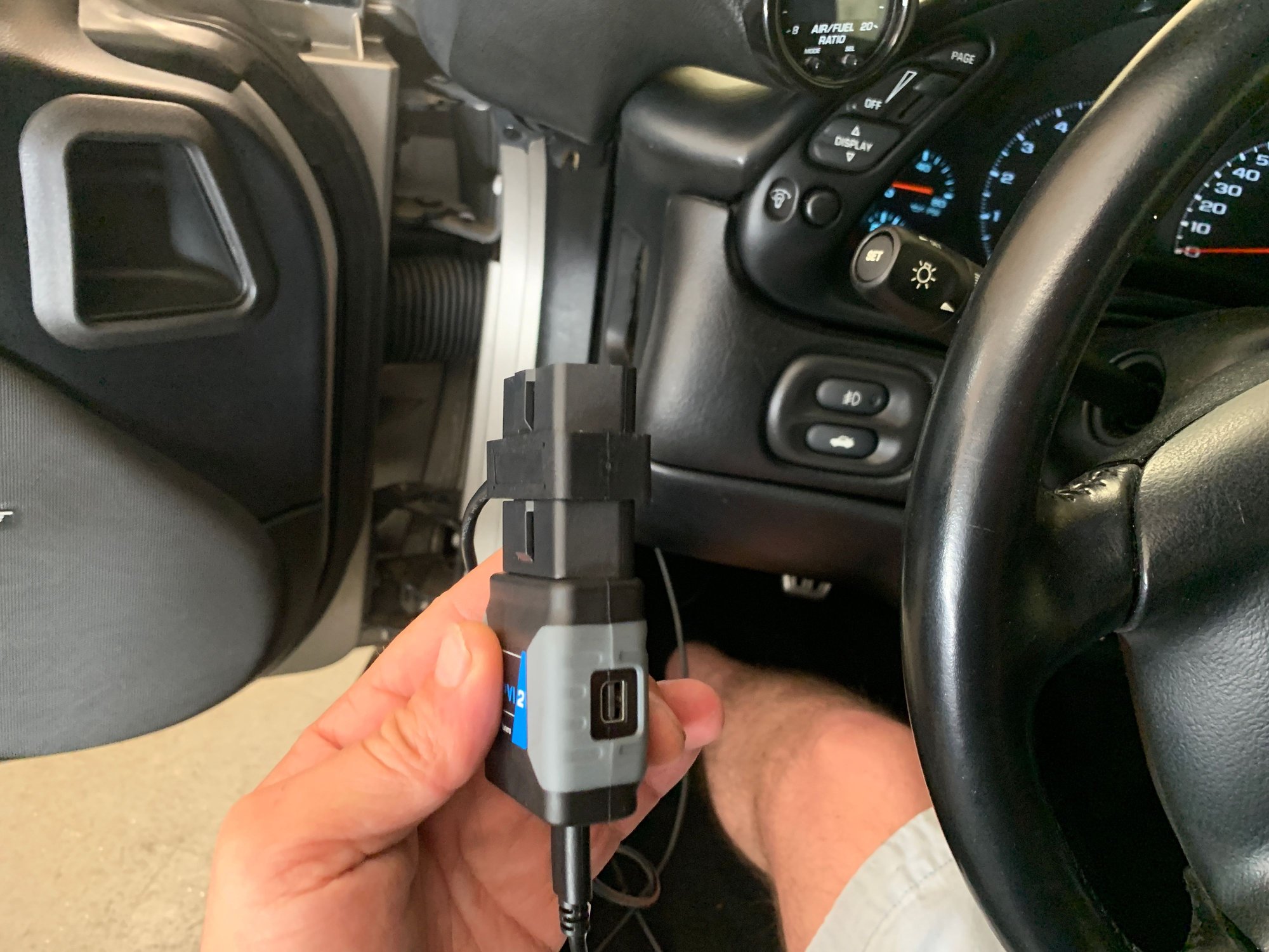

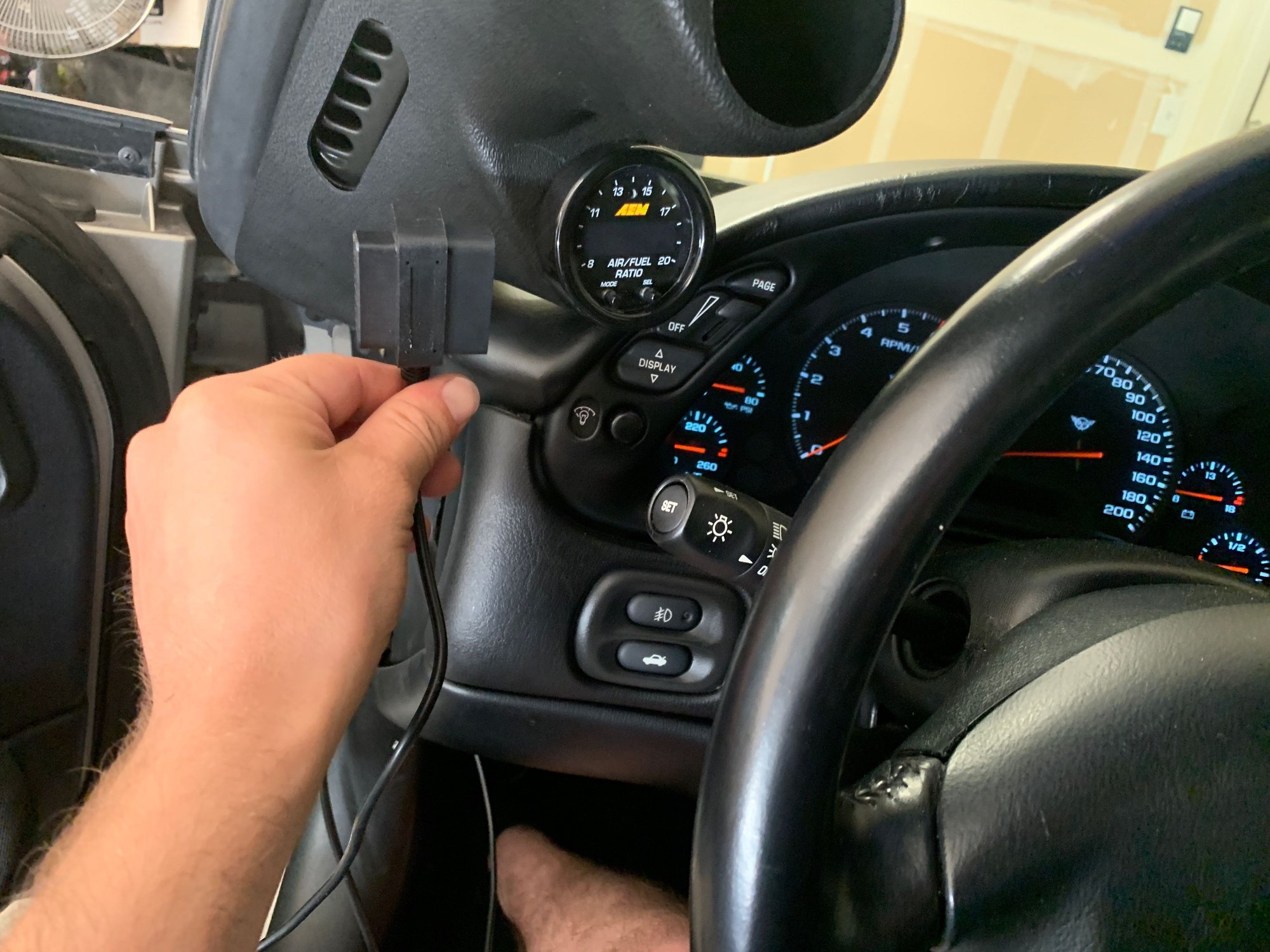

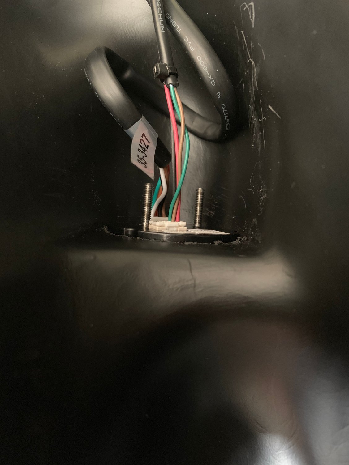

Theres a side port on the MPVI2 the tech mention the something about a analog module being spliced in to get to read because the pcm is old it’s the 334 was for 2008-current. The only loose wires I had I ran over to the radio unit for power and ground rest all go to a harness on the back of the gauge! Maybe I need this?
This is what I’m working with!

I figured this out I need to get the pro feature and they give the cable free to me I need . I will consider this thread closed for now.
