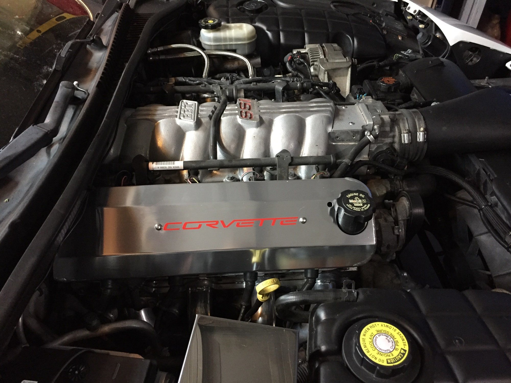

looking to upgrade my fuel rails Ive seen a lot of upgrades but not sure what will work with my bbk intake.
any help is greatly appreciated.

are those stock ls1 injectors and rails currently on the intake?... the ls3 injector spacing is different so you would need the correct mounting blocks or spacers to make those work... if your stock rails bolt up to the intake I don't see why any aftermarket ls1 rail like fore, fast, etc wouldn't work as well just make sure you get the correct hardware that works with your injector lengths... also factor in the cost of new fittings and lines to make the aftermarket rails work, it can add up fast
