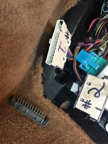

Sounds like a "classic" serial data bus issue !!....funny, so the chime sounds, most DIC warnings...low fuel, REP, service vehicle soon...your fuel gauge goes to empty, water temp gauge pegs out high, windows inop ...yeah buddy !!...now usually if a power or a ground (usually power) gets on the serial data line that's what you'll see...NORMALLY it will be a START AND STALL or NO START !!...your car runs right ??...if you have a bad ground say on one of the car's modules the ground has to find it's way home...it will jump on the data line to get home...Bill Curlee our resident electrical "Professor Emeritus" has documented this issue extensively here on the Forum...since it's just your Pass door there is a connector inside the rubber accordion when you open the door...since the door opens and closes many times that is where your issue may be...pull back that accordion to access the connector...look for corrosion, poor pin fitment etc. if stay happens easiest thing would be to access the passenger door module or remove the "STAR' connector next to your BCM and find the connector with the 4 or 5 wires...pull the plastic comb off it and it will isolate the passenger door module...see if that fixes it ??...I'm in the middle of filming a YouTube video covering this so stay tuned !!...hope B.C. chimes in !!

Had a member with a Seat Control Module a while back who had a start and stall on his...he said he just unplugged it, inspected it and re connected...that fixed his !!...I would not only look at the PDM connector but the one inside that boot as well !!...yours may have just been an intermittent condition...if checking with a scan tool you will have ALL "NO COMMS" with all the modules if not intermittent plus the car won't start !!...none of the modules can talk to one another !!
