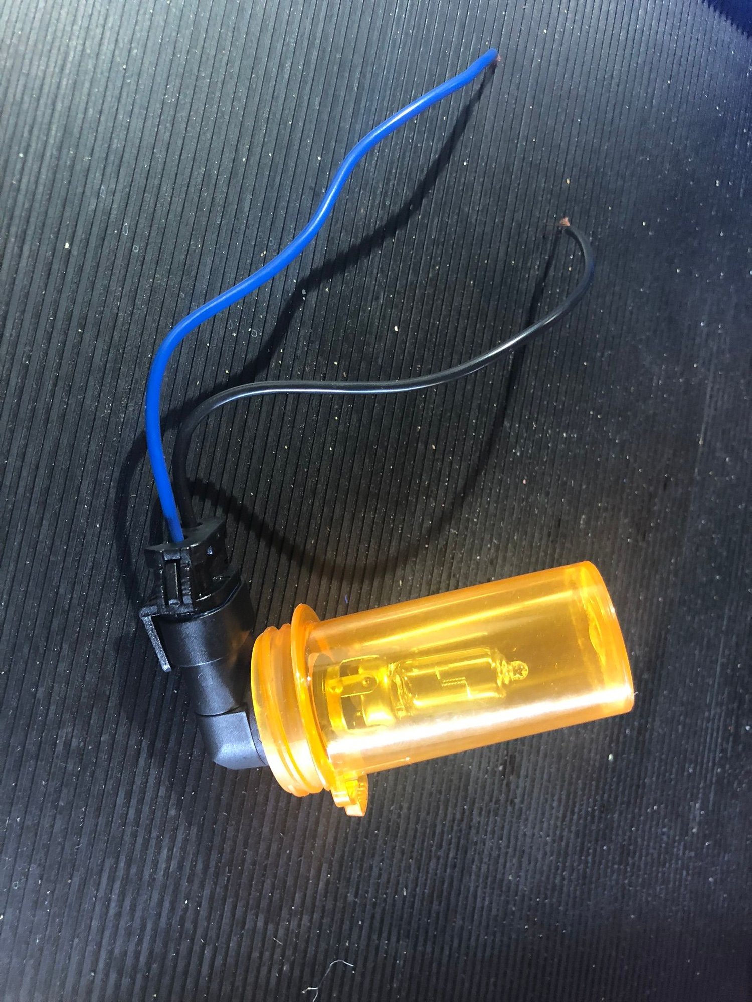

I did a YouTube video recently on checking the fuel pump circuit on the relay end...if you have questions let us know...quick check of the pump circuit is to jump pins 87 and 30 with the relay removed...if the pump operates that half of the circuit is good...if not let us know !!
P.S. In the video I'm using a test light to check the grounds...I use an old headlight bulb (pictured) to "load" the ground circuit...if the light is not bright there is not enough current flow going through the wire...GROUND RESISTANCE CHECKS USING AN OHM METER IS NOT THE WAY TO CHECK !!!...you can get a bulb (55W) at the "Zone" for a few dollars !!...and BTW what issues are you having "cranking no start" ??....use should include the info about your car such as year and mods in your profile !!...this helps us help YOU !!!
