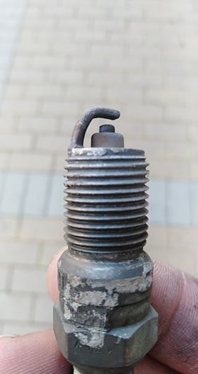

Hello Everyone, I have a 2002 C5 Z06 and I did hear an exhaust leak recently..and today I heard a loud "pop"..and a LOUD ticking sound..turns out the spark plug popped out. I read a thread about this in 2007 on this forum, and it was suspected that the block needed a helicoil..but in the end it turned out the spark plug just "wiggled" its way out because it wasnt tightened properly..so..just had to ask..what everyone thinks (as I wait for the engine to cool down)..here are pics
it's the fourth (furthest) hole on the drivers side..near the alternator...
this is the spark plug
based on these photos, do you think it's the hole or just not a tightened plug? thanks in advance...

the plug is steel and the heads are aluminum so if anything got messed up it would be the threads in the head since the material is much softer... I would just put a light coat of antiseize on the plug threads and try to thread the plug back in the head and see if it goes in smoothly and is able to be tightened properly

Kind of hard to tell from the picture but I'm not seeing any threads in the head. If there are threads there then you may have gotten lucky. It's really not that hard to drill, tap and then hellicoil the aluminum head if you need to. I know a local guy that's had one done and has lasted for years now.

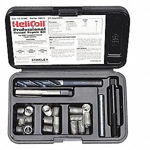

This issue is BIG on the Ford 4.6,5.4, and 6.8 Triton engines...same thing with a steel plug into an aluminum head...even happened to me on my 3.0 Escape when I had it !!...no need for the head to come off...just drill, tap, and install a helicoil !!...you can buy a kit for doing it as you can see here.

They will go into the combustion chamber but when I did my truck (luckily mine was easy one in the front-transverse engine) I coated the tap with heavy grease and most of the big stuff stayed with the tap and what was left was vacuumed out with an adapter I made with my shop vac....put my borescope in there to double check...now a few tiny chips wouldn't hurt the engine but a half inch one might !!

I had one pop out of my 99...it is possible the plug was not tight enough and worked it's way out. I had no warning...just athe aftermath of it blowing out. We were able to screw it back in and properly torque it. I do use anitseize now and have had no issue since....

if you zoom in, you can unfortunately see that the threads are gone deeper in..so thanks for everyone's advice...I will try to either rent or buy a helicoil kit and try to install an insert...

I can't tell how many threads or thread condition from the pic
The pic of the spark plug indicates is has been leaking for a while!!
Try threading a new plug in. See how much thread engagement you get vs another known good cylinder. (i.e. the cylinder in question gets 2 full turns vs 5 full turns or whatever it is). If it's within 70% or so, thread it in and don't worry about it. If you're lucky, the PO just put that plug in by had (1/2 turn engagement or whatever), never tightened it, and it's been that way since until it popped out.
