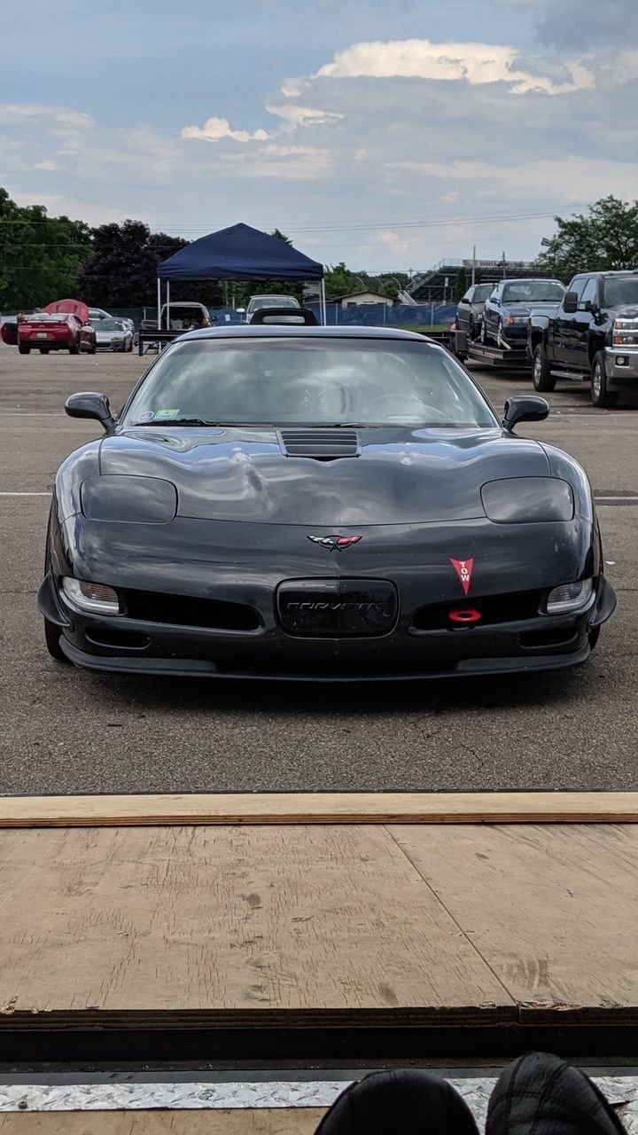

I installed an APR wing and balanced the front downforce with a duraflex lip splitter (the one with the center vent in the right place) and canards. For the first time I'm seeing water temps in the 250 range and oil up to 297. The Glen is hard on engines with a lot of climb and constant redlines, but I've never seen close to those numbers elsewhere so I have to assume it's the splitter breaking the normal airflow.
Is there a trackside fix that I can apply that doesn't include removing the splitter and unbalancing the car? Willing to cut the bumper cover, I have another. Trying to break into the teens on street tires and having to short shift to keep the temps down. Help save my track event!

I think I found the culprit. I had been thinking that the duraflex spoiler shouldn't impede the airflow as it simply breaks the flow into upper and lower, but in fact it extends too far and reduces the air channel under the spoiler to about 3". This is way smaller than the normal air chute that exists without the spoiler. After some cutting and reinforcing the fiberglass I have a good under air chute again, so looking forward to my track day tomorrow in 95 degree temps to see how it goes. Image attached to show the splitter style.
